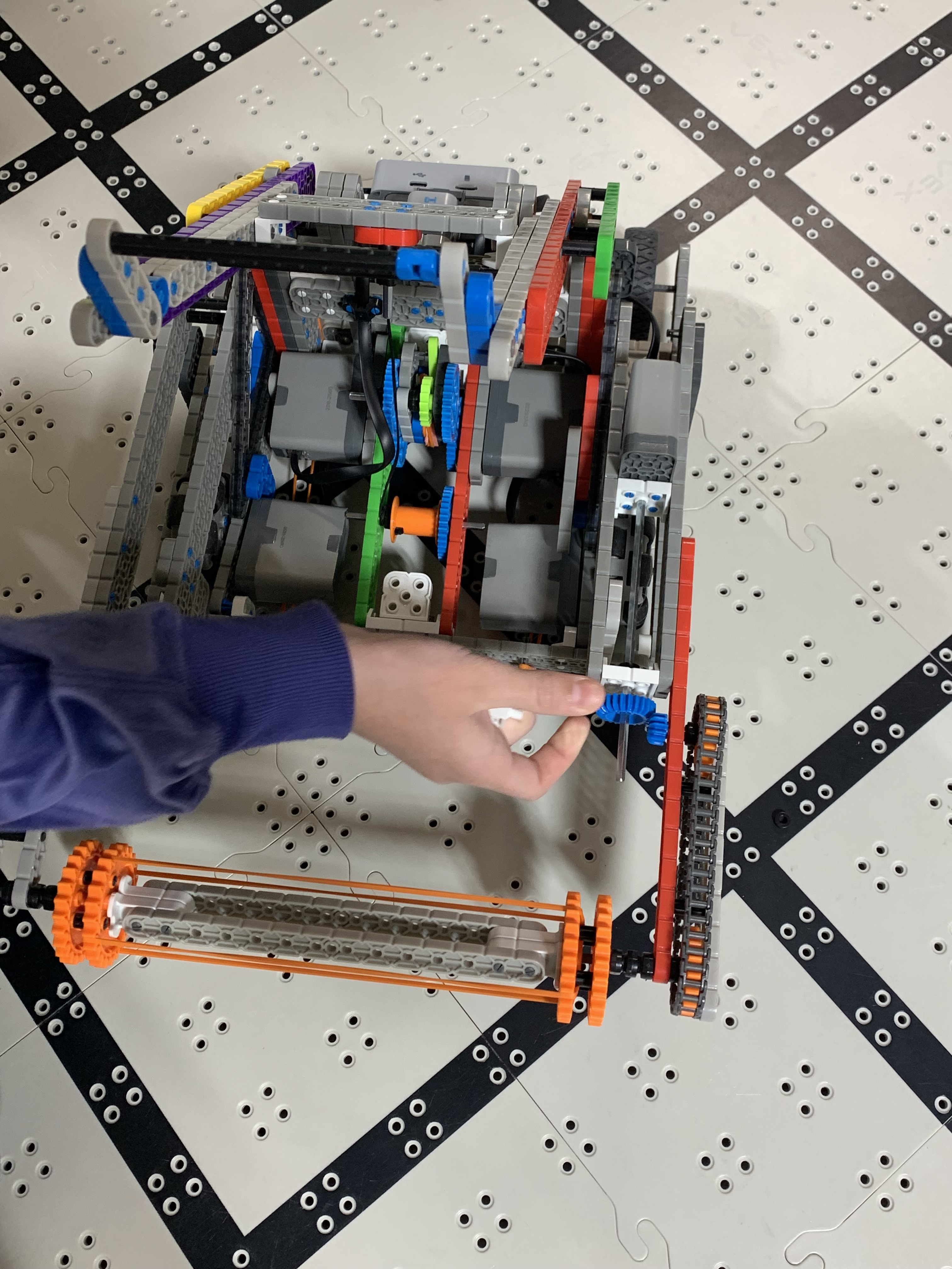

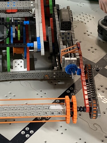

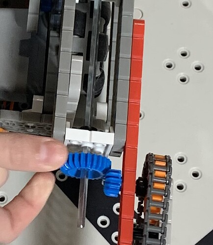

The team is using the swish herobot and the intake gears aren’t connecting to spin. They tried adding a rubber band and it works as intake but then when they lower the catapult the gears grind.
This is an issue with using hybrid gears. Try encouraging your team to explore ways they can powr the intake without using hybrid gears. bevel gears or crown gears!

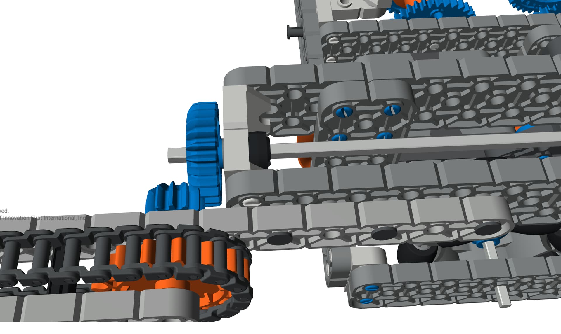

comparing your build
with the build instructions
It looks as if the build is incorrect.

It seems that the gears you are using are too close, so one of them is pushing the other, which may result in a twisted axle. Move the gears for the intake back a little and they MIGHT not grind in theory.

@Journeyshomeschool if you are still looking for a solution, I believe I see it. It isn’t about the gears, it is about the beams. The instructions show the 1x beam in the middle holes of the 2x beam. You have the 1x beam in the top holes of the 2x beam. See the screenshot.
