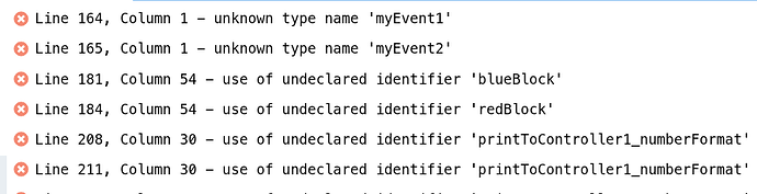

fix the missing variables like blueBlock etc.
Any chance there is an ability to do a slideshow/revovling images as I would love to have memes rotating on our brain during a match!
What do you mean about the missing variables? I am using a AI sensor and I thought it automaticly put them in.

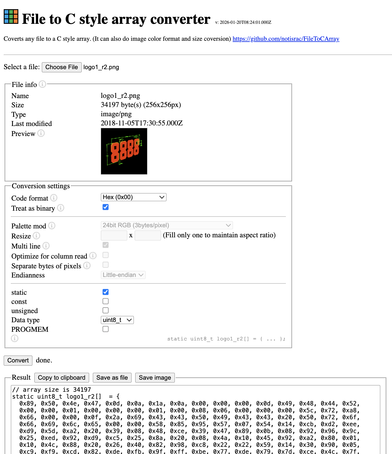

Just want to post a warning for anyone using this technique.
This can create executable files larger than the V5 can handle if you are using lots of images, for example, to create a UI. The V5 has a hard limit of 3MB for files in the file system, VEXcode will use compression to get the executable size down, but sometimes this doesn’t work and the program will not download correctly. We were checking feedback on a VSCode download issue this morning, the program used over 3MB for just the several images embedded into the code causing download to fail.
You would be far better off using png images converted into a C structure and using the existing “draw image from buffer” API. Images in the feedback project were using ~420K of memory each, the same image as an 8bit png file is around 20k, approx 20x smaller.
To convert images there are a number of online converters, one such is here (which I found at random but seems to work, not endorsing it in any way)
an example of how to setup after you choose the image (ignore that this image is too large for the V5 screen, images should generally be 480x240 or smaller)
The image should be a png image, you may wish to process in Photoshop etc. to reduce the size by converting to 8 bit indexed format first.
you then copy the array to your code, it might look something like this at the beginning of your program, however, usually I put this type of data in a separate file and include it where needed.

Then use as follows
Brain.Screen.drawImageFromBuffer( logo1_r2, 0, 0, sizeof(logo1_r2) );
