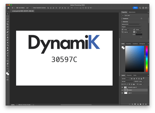

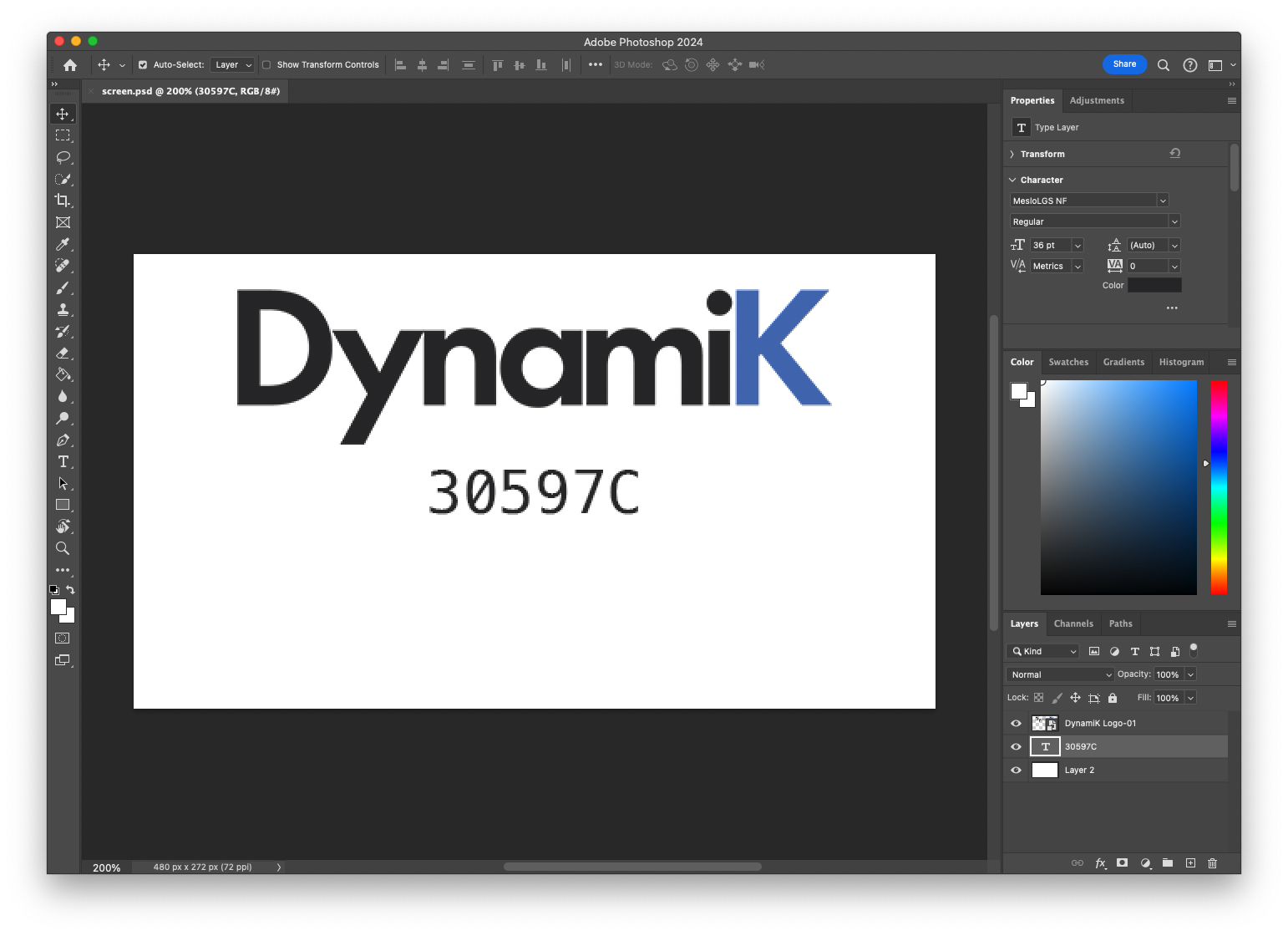

  1. Prepare Your Image: Create a PNG with the dimensions of 480x272 pixels, the exact display size of the V5 Brain.

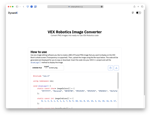

  2. Upload and Convert: Visit https://suhjae.github.io/vex-image/ and upload your image. The web app will then work its magic and generate C++ code for your image.
  3. Implement the Code: Copy or download the generated code and integrate it into your robot’s programming.

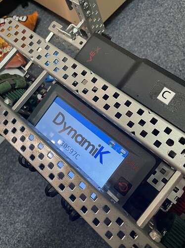

  4. Display Your Image: Within your robot’s code, call the drawLogo() method to bring your image to life on the V5 Brain’s screen.
I created this tool with the hope of making it easier for teams to customize their robots and add a personal touch without the hassle. I’m excited for you all to try it out and look forward to your feedback!

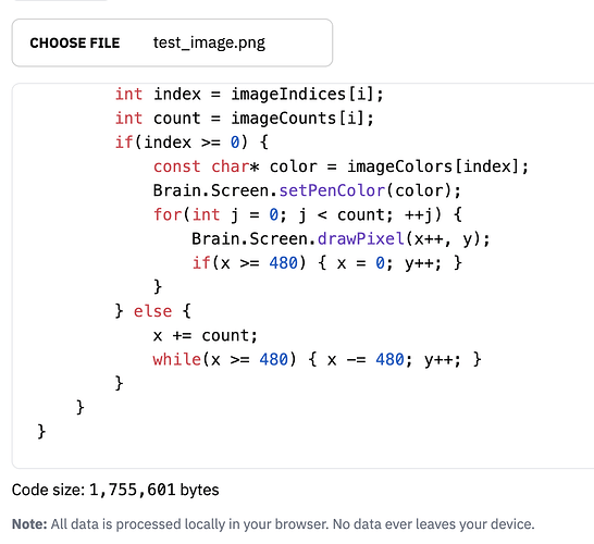

I had a look at this out of interest and have a few comments.
First, the area of the screen available to user programs is actually 480 x 240 as the top 32 lines are used for the V5 statusbar. This means that the last 32 lines of any image displayed using this code will be cropped.
Next, the code seems to run length encode the data, a color chosen from a lut is repeated for a run of pixels. While this will work for simple images (like a team logo) it will not work well for a complex photo realistic image (and actually the web site more or less crashes if given that type of image).
Finally, I wonder why you took this approach rather than just encoding the png data into a C array and using drawImageFromBuffer which will decode the image directly.

web site finally finished processing the test photo I tried, rather large data structures, 1,755,601 bytes

You are indeed correct, and I greatly appreciate your invaluable feedback. First and foremost, I want to thank you for taking the time to review the web app and for your detailed observations.
Regarding the screen dimensions, you’re absolutely right about the V5 screen’s usable area being 480 x 240 due to the status bar occupying the top 32 lines. I will promptly adjust the application to reflect this correct dimension to ensure that images are displayed without being cropped.
The original intention behind the encoding scheme was indeed to optimize for simple, flat images such as team logos, which typically have a limited color palette, rather than complex, photo-realistic images. This approach was chosen to minimize the size of generated, and compiled code, aiming for efficiency in images where color runs are long and repetitive. However, I acknowledge the limitation you pointed out, where the application struggles with more complex images due to the current run-length encoding method.
I was aware of the alternative method of using drawImageFromBuffer to directly decode PNG data into a C array, and I did experiment with it initially. My motivation for developing a custom encoding scheme was to explore a solution that potentially offered smaller code size for simpler images. However, I understand the advantages of direct image decoding, especially for more complex images, and the significant reduction in processing time it can offer.
Based on your feedback, I am motivated to enhance the web app by adding a feature that allows users to toggle between the current encoding method and the direct buffer approach. This will provide more flexibility and accommodate a broader range of image complexities while addressing the issues with file size and processing time for complex images.
Thank you again for your constructive feedback. It’s insights like yours that drive improvements and innovations. I look forward to implementing these changes and continuing to evolve the app to better serve the Vex community.

RLE encoding is a perfectly valid way to encode simple images. Most of the icons and images we display on the V5 (EXP and IQ2 also) are encoded as 8 bit bmp images with run length encoding. That format uses a 256 entry color lookup table and a similar method to that you have chosen.
My career before VEX was related to digital imaging in the entertainment industry. At one time the most popular computers used for post and CGI were made by a company called Silicon Graphics. Their preferred file format for images also supported optional run length encoding,
Anyway, I should have said before, nice work and web site.

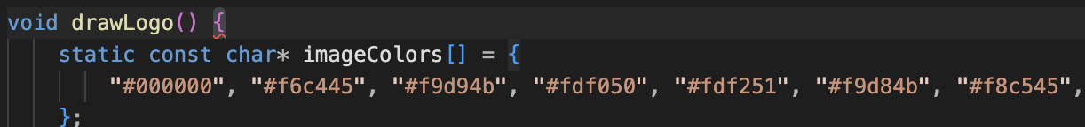

Hey this is great, thanks. However, I am totally new to text coding. How do you do step 4 - "call the drawLogo() method within the the robot’s code? Can you give an example? Many thanks!

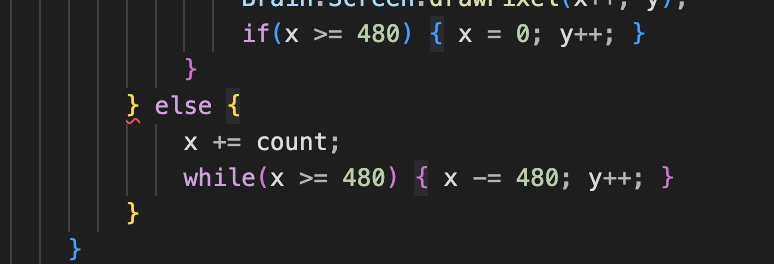

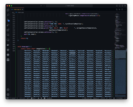

what is going on here
Looks like you don’t have matching braces { } Can you publish ALL the code and we can look?
I am sure I have all the brackets though
There are 9 pairs of matching braces
so it’s a syntax error of some sort, either brace, semi-colon, comma, something like that. Without being able to see your code we cannot help, good luck.
