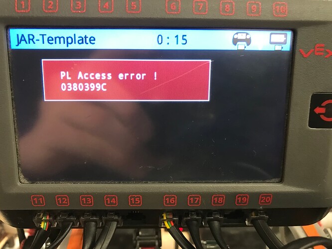

Hi!
Just found and set up this code on my four motor, two rotation sensor drivetrain and I have a couple issues:
  1. After pouring over the readme, I still have no idea how to enable autonomous to run a example program
  2. Several PL Access and Memory permission errors present themselves when using a controller, and this is tied to something about the arcade controls declared in user control.
  3. Does the tank drive two rotation sensors imply the use of one parallel rotation sensor and one perpendicular? Or both parallel?

Send me your code exported as a zip, and I’ll have a look.
I am getting similar PL access errors. Any solution yet?
Again, I’d be happy to look at the code that’s causing errors.
All the one sensor options imply a forward/backward tracker, and all the two sensor options imply two perpendicular trackers.

Some info that may or may not help. I am using a 6 motor drive, and one tank drive rotation. I do not wish to use position tracking so I just left the rest of the position tracking variables as they are, as said to do if position tracking is not used. Right now I don’t have anything past the testing autons set up, because I wanted to just compile the program and see the values printed to the screen so I could tune.
Here is the message of the error. This message only seems to happen when the controller is connected. When the controller is off/disconnected, the screen just says Drive Test.
I’m sure there is some simple solution/problem in the code that I’m not seeing. Thank you by the way for creating this, and helping out.
The only glaring issue is that you’ve set your drive style to TANK_ONE_ROTATION but don’t intend to use odometry. I suspect that switching your drive setup to ZERO_TRACKER will fix this issue. TANK_ONE_ROTATION is only meant to be used on robots with external tracking wheels that will use odometry. In the next release, I will make the drive setup names less ambiguous and provide clear documentation, and also add support for a lot more drive setups.
The reason this is a problem is that the Drive constructor will look for a rotation sensor using “PORT1” format, but the default sensor there is just in “1” format. If switching to ZERO_TRACKER doesn’t fix the issue, let me know and I’ll get a robot and try to replicate the issue.
@dat_VEX_guy if you can debug your code using this post, great. If not, send me your code and I can look at it.
Hello, thanks for the response. Unfortunately, this doesn’t seem to have changed it. I still get the same error. Thanks for clarifying about the drive type, I misunderstood it as a tank drive with a single rotation/inertial sensor on it, but that makes sense now. Thank you for helping.
