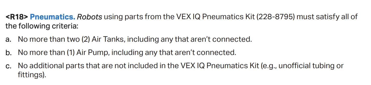

According to R16 ( R16), only one Air Pump can be used. I believe this isn’t true, as each pneumatic solenoid has a port for the pump. Can someone confirm to me if I can use 2 pumps or not.
I think you mean ?
Anyway, you have your answer on how many air pumps are legal to use. The game manual isn’t trying to trick you, it tells you exactly what is allowed and what isn’t
For some reason it’s hiding when I try to say R18?
(I said it with the < so maybe that’s why?)
surrounding text with < and > (without spaces) hides it
Idk. I’m unsure also because at regionals last year we passed inspection with 2 pumps on our robot. I also don’t understand how we can use 2 solenoids with only one pump, because for a solenoid to work, doesn’t their have to be a pump connected to it?
The game manual is very clear on this.
Use a splitter (T connector) to send air to the second solenoid.
