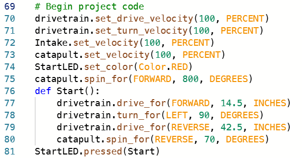

Hi all,
Our team is having a problem with our robot where the python line: drivetrain.turn(left, 90, degrees) is not stopping its turn at 90 degrees of rotation. Instead, it just keeps on spinning with no end in sight. Here is a pic of our code.

I can’t see any issues in our configuration. We have a 2:1 gear ratio, our wheelbase is configured right. In our driver code, everything is correct and it all works fine. Our problem is that the rotation does not stop after 90 degrees.

Thanks for the guide! Our problem was that we set the drivetrain to reverse and then swapped the motors in the code, so everything was messed up. It works fine now. Thanks!
