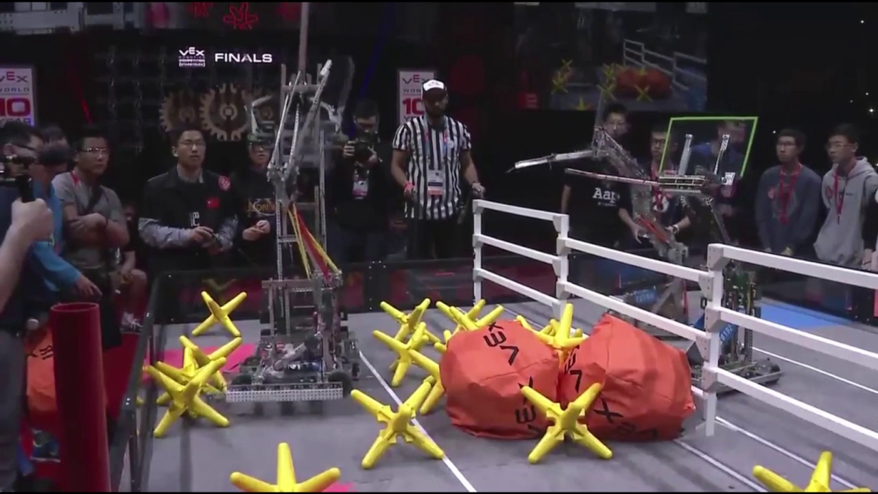

Are they considered grabbing it? Or are the considered a “wall bot” allowing for the opposing robot to do whatever it takes to try to get the mobile goal? Including flipping the robot if necessary due to the robot intentionally preventing scoring?
Since when are there special rules allowing people to do anything to wall bots? I have read the game manual several times and never saw anything about this
I didn’t know if due to them getting in the way of scoring, maybe that allowed for special rules, as I believe robots are allowed to do what they need for scoring if a robot is intentionally blocking such as at world last year if a robot intentionally tried to block a robot, the robot could try and score there, and if the robot just so happened to get in the way, then that is their fault
I would think that robot would be considered attached, it is clearly not accidental, and even if it was, the mobile goal has no way of leaving its grasp, therefore it is a warning if not match affecting, and a DQ if it is.
Would this be correct? Due to them intentionally getting in the way, that is their fault?
I think the getting in the way part is true, but there are no special rules. Meaning just because a robot is in the way of your scoring you can’t like use their claw to pull our their wires etc.
Like in this example
