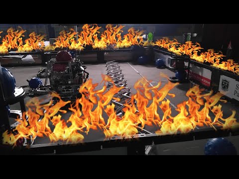

Let me introduce you to someone.
Summary
This is what 1471A did back during Toss Up, when they created Apophis the Quadropus.
1471A Toss Up Wallbot Reveal “Apophis” AKA The Quadropus - VEX V5 General Discussion / VEX Robot Showcase - VEX Forum

Pretty sure what your talking about is a tether bot. or basically 1 robot brain that effectively runs 2 robots. kinds like this:
unfortunately this years expansion rules don’t allow for this type of design. i have always wanted to try my hand at a tether bot but expansion rules have been to strict in recent years.
