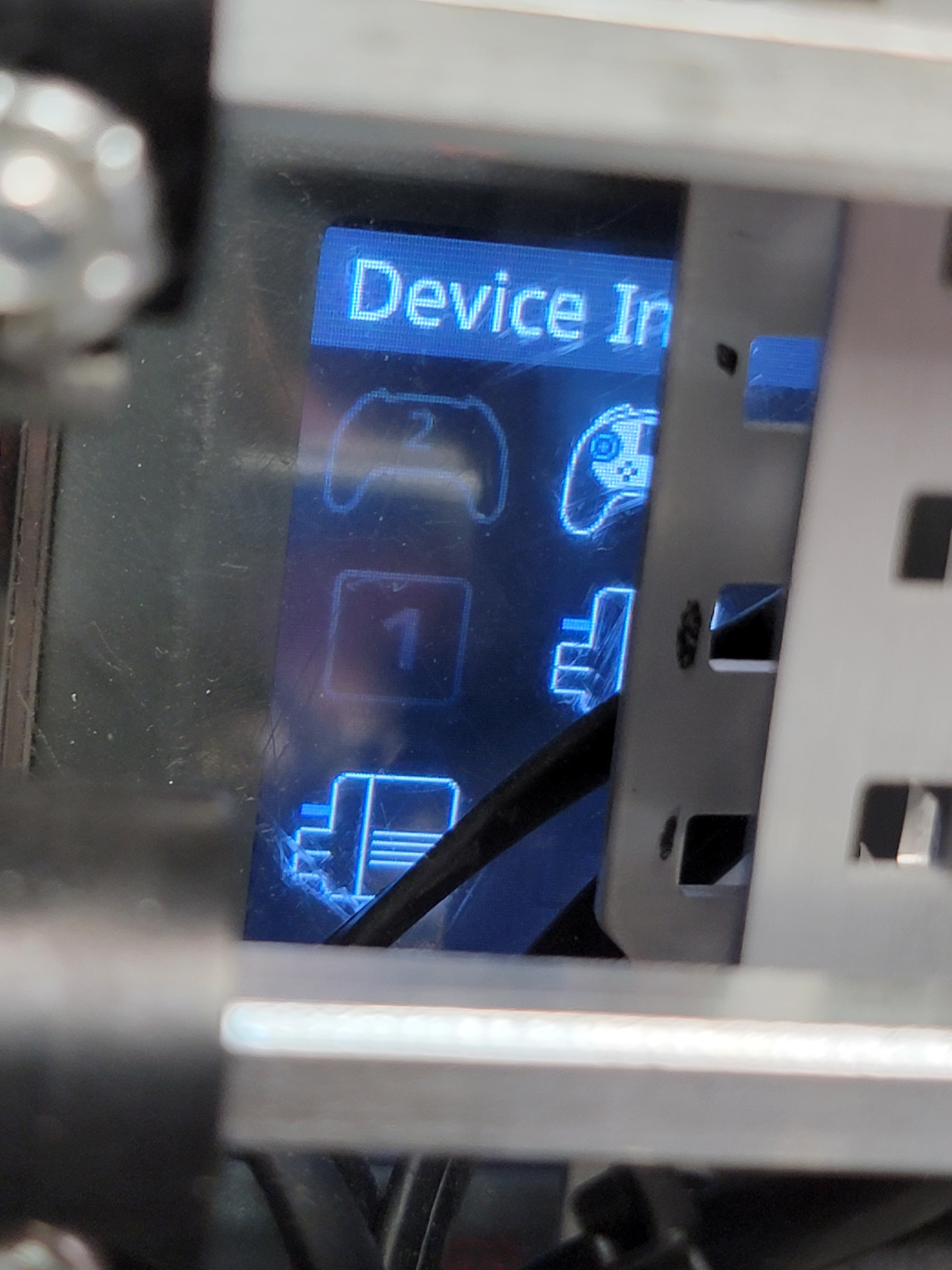

Hi all. I have written some code for my GPS sensor, and it spins in a circle. When I plugged in the GPS sensor and the light was flashing, I assumed it was a port issue and tried many things such as switching the cord, moving ports, trying motors with the same conditions, etc. I’m down to the conclusion that my GPS sensor is probably dead, and wanted to either try and see if that ounce of hope is worth it, or see if it’s repairable.
When using GPS.display(), it returns a 0. It doesn’t show up on the devices on the V5 brain. GPS strips are properly installed on the field I tested it on. Included below are both the code I used, a GIF of the phenomenon happening, and the V5 brain not detecting it. It is plugged into port 1. (excuse the bad angle).

Blinking Light
ezgif-5-05def7bbc9
No Sensor on Brain
Thank you!
Has the brain’s firmware been upgraded?
Yeah… that was it
Thank you so so much, I can’t believe it was as simple as that. I was unaware I needed an update because I plug into the controller to install code.
