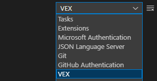

You can find the log by following these steps:
  1. Clicking Output
    Screenshot 2022-09-26 104218
  2. Click the drop down box, and select the text “VEX”
    Screenshot 2022-09-26 104346
  3. Copy the output log and send it to me.

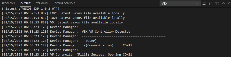

Hi hphilips,
Thanks for the response. I am using the Vex v5 controller, and when I selected the prompt for the creating a project I choose Python.
Thanks

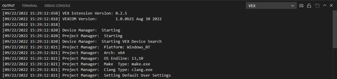

Can you attach or post the full log in a code block like so:

[02/15/2023 09:34:29:752] Device Manager:
[02/15/2023 09:34:29:752] Device Manager:  VEX V5 Controller Detected
[02/15/2023 09:34:29:752] Device Manager:  ---------------------------------------------
[02/15/2023 09:34:29:752] Device Manager:  	-(User)
[02/15/2023 09:34:29:752] Device Manager:  	-(Communication)  	 COM13
There is more version information that I need to see that will help me reproduce your issue, such as extension version ect.
Can you plugin your controller and perform a download that causes your controller buttons not work. I would like to verify that there wasn’t an issue with the user program download.
Then send me the full log.

Here is the full extension log
[02/16/2023 07:12:50:420] VEX Extension Version: 0.3.0
[02/16/2023 07:12:50:523] VEXCOM Version:        1.0.0b21 Aug 30 2022
