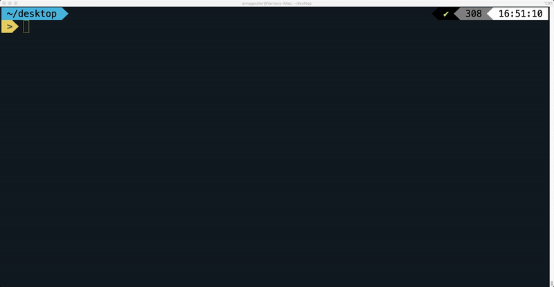

Hi I’m Zach. I’m currently in 7th grade and I was wondering if there are any NPM packages or GitHub repos I could clone to access any of the robot’s apis.
Thanks

It already seems like you’re far above the average vex iq skill level, considering you’ve even touched a terminal (also is that zsh?). Go download vexcode. You can either use python or cpp. It will take some time to adjust, but you’ll be fine. The level of programming needed is very little for iq. Your robot build will matter much more than your programming. Worlds level programming in iq is really just PID.
