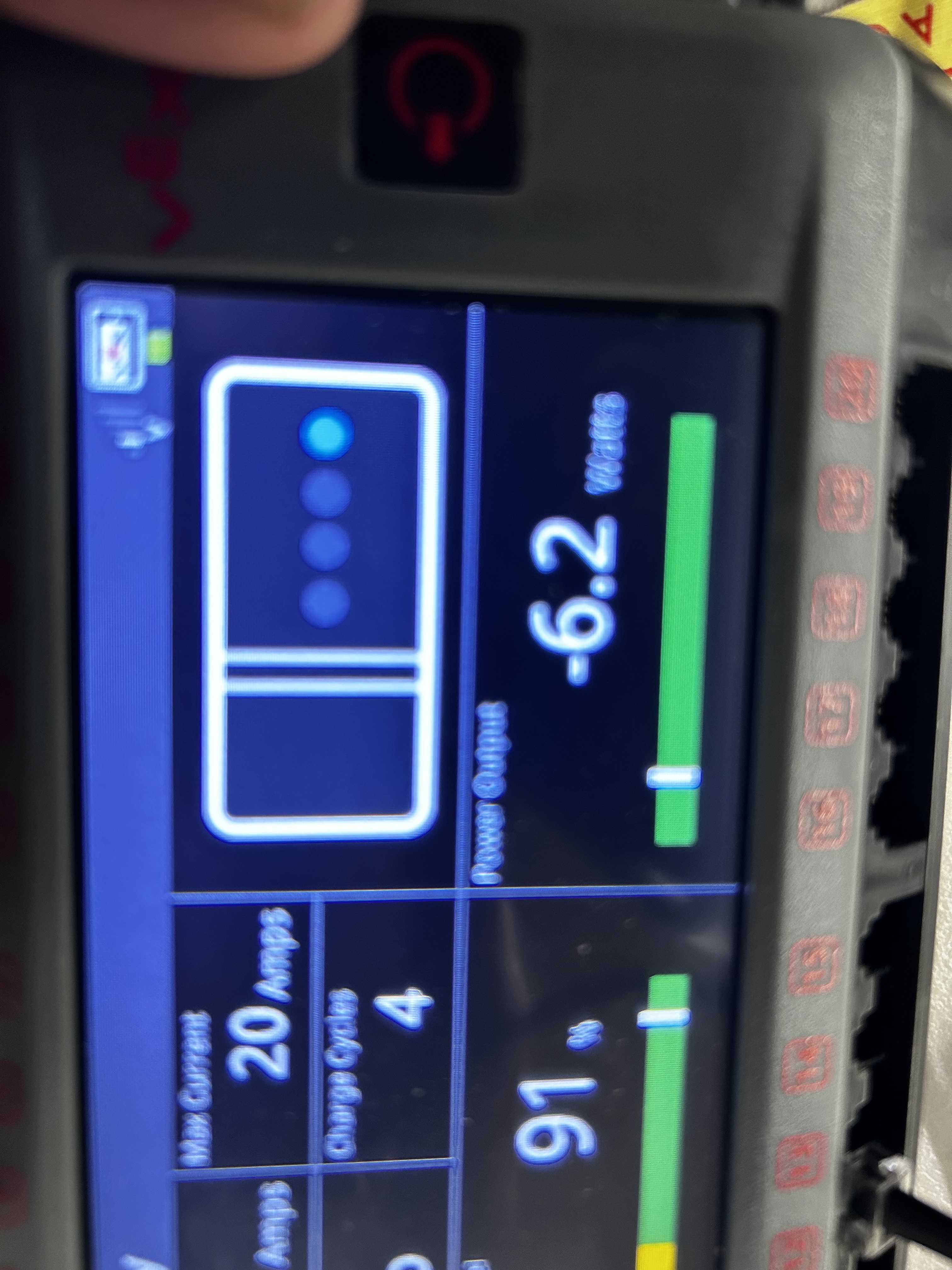

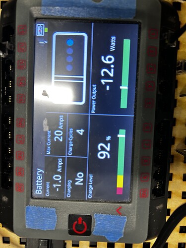

So I was looking at the power output of both V5 Brains. The brain with the working Jetson Nano connected to it displays a higher power output than the Jetson that does not work. Could this be the issue, and if so should I get a new Jetson?
