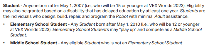

From the new manual:
https://content.vexrobotics.com/docs/2022-2023/viqc-slapshot/GameManual01.pdf

This entire topic is an area that I think needs to be addressed better by the RECF. I can understand the rationale behind having the age-based student definitions, but hanging on to the old naming of âElementary Schoolâ âMiddle Schoolâ and âHigh Schoolâ continues to cause confusion.
According to the rules, an Elementary Student is anyone under age 13 by Worlds. A Middle School student is anyone under age 16 by Worlds (both IQ and VRC), and a High School student is anyone under age 19 by worlds (also have to be in high school).
