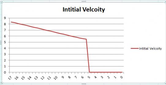

I used the spreadsheet I made to calculate the required launch velocities for a bunch of distances, from 17ft to 0, taking measurements every half of a foot
attached is the image of the graph it forms, and, you will notice the plots form a perfectly straight line, how could this be a linear relationship, and if it is truly linear, why all the fancy equations?
also, if it is not truly linear, could one write a linear approximation of it that would be close enough that we don’t care?
the sharp drop to zero is where the equations become impossible, essentially where that shot cannot be made a t a 60 degree launch angle
so I calculated the linear regression of the line, and then plotted it in reference to to the calculations out of the spread sheet, and got a differences of up to 5 Cm/s in terms of Vo, so it’s no good for getting an actual answer, but it makes a really good first guess for not program solving numerically for the answer, and is a lot simpler than the equations I was using before
So I don’t think that graph looks correct. The graph should be fairly linear, but not exactly. Here is my plot. This data is for a ball launched 18in from the ground at a goal 36in tall.
https://vexforum.com/attachment.php?attachmentid=9347&stc=1&d=1431891968
Notice how much larger my initial velocities are? With out knowing what kind of model you are using (are you including drag?) I can’t tell you what the problem may be. It is quite possible though that mine is wrong. You could approximate the relationship between initial velocity and range to some degree. However, it looks like this breaks down for short shots.

EDIT: Actually, I think I see the problem I had with the graph you showed. The range is measured in feet and the initial velocity is in meters per second, isn’t it? If that’s the case, the plot looks correct. Although, because the important data is scrunched up you cant’t really see the slight curve.
your assumption is correct, the bottom line is in Ft, and the top in meters, and I have noticed the curve, when I plotted the error, and multiplied it by 100, you could really see it, but because the range of our equation is so short, 0 to 17 ft, the equation is close to linear, at the edges of the graph the error would cause the landing distance to be about 5 cm off.
I am solving for Vo numerically and my quest has been to get the required number of iterations down as low as possible, so first I just added part of the error to the velocity to be tested in the next iteration, and i just started all my guesses at 10 m/s. it then took 11 iterations to get below 1 cm of error, next I analytically solved for Vo in an equation not counting for drag and used that number as my first guess, that got my error down to less than 1 cm in 3 iterations, and using this new linear model as my first guess, I got it down to 1 iteration, I use the linear model as my first guess, make on correction and it is less than 1 cm error for anything between 0 and 17 ft
