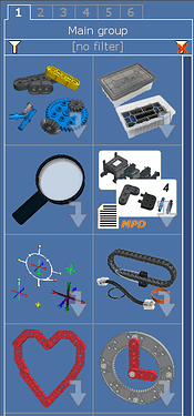

Can you make sub assemblies (like a wheel, shaft, sprocket and spacer combo, where you can easily drop the completed assembly in your top model 4 times?
Yes to all of those. You can also do chain (even chain triangles), rubber bands, etc. I figured it out in just a few hours, and used this to help me with more complex stuff. I’m sure there’s other resources out there too. You can DM me if you want to organize a meeting so I can show you how it all works if that would work better.
There aren’t a whole lot of resources on LDCad. And there is little to none about LDCad for IQ, but the normal LDCad resources online, although they are for lego CADding, will be able to get you to do build some robots.
Yep! I figured it out!!! (Most of this is explained in the link @FRC973 sent, but I’ll explain it here anyway)
First, in your main model, click this button at the top:
then, name the sub-model (it will end with the .ldr extension).
then, if you want to use the submodel in the main model, go back to your main model by clicking the current model name in the top right corner (or press the END key while your cursor is in the editing area)
then, go to “Main Group” in the parts directory (should look like this)
then, click this in that menu:
then, you have a few options:
I recommend trying them all out and seeing which one works best, but basically you go into one of the menus, and you will see the submodels of that category, you can then drag it into your main file (as many times as you want) as if it were a normal part. From what I understand, you can also make submodels of submodels and navigate through those using the “All parts used in the current model (recursive)” category.
