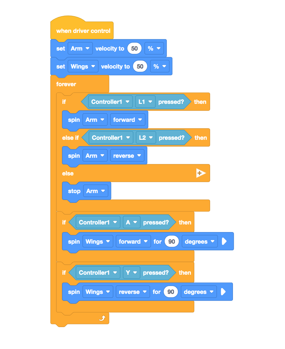

We just came back from a competition. We used this block code on our robot. We weren’t able to run it on the drivers skills portion. We had to use a field switch to operate in drivers skills. We also set up the controllers as well.
The autonomous code wouldn’t work properly once we were connected to the field controller. It was supposed to move 36 inches and push the triball under the net.
We were told that we needed something programmed in all three blocks, including the when started block. Also told that we need “My blocks” on all three blocks. I think we also should of used the “if then else” block"

You do not “need” MyBlocks. They can simplify the block stack if it is repetitive, but using them is optional.
yea, the driver control code is, well, just wrong.

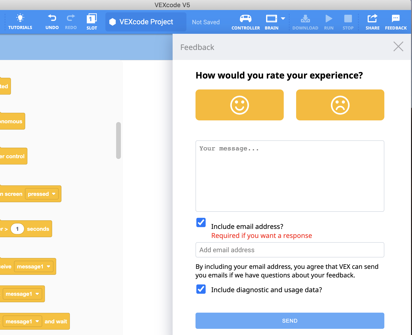

I’ll rewrite tomorrow for you if I have time. perhaps send me your project file so I can see the configuration or use the feedback tool in VEXcode when the project is open.
Okay thank you! I’ll send you a snapshot of how we have our controllers set up as well. Not sure what you mean by project file or feedback tool.
The .v5blocks file on your PC.
Top right button, using feedback with the project open will also send that to the tech support servers that we can access if diagnostic data checkbox is checked.

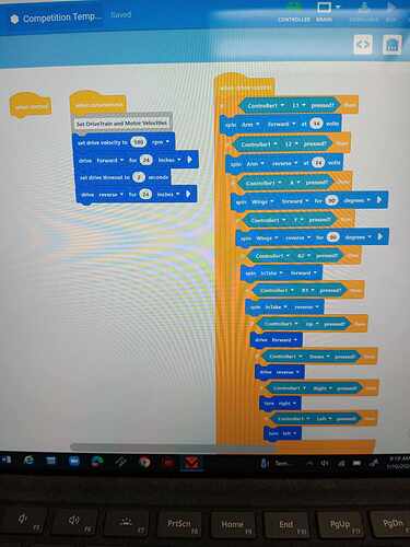

Ok. Here is a basic code template for movement.
The top picture:
When started:
This runs ALL the time. I’ve put some code here that 1) clears the brain screen and 2) displays battery voltage to the screen. You can expand this to monitor motor temps (HIGHLY recommended), motor degrees, etc.
When autonomous:
This runs in auton mode, which is triggered by the ‘countdown’ mode on the controller (for testing) or the field switch (handheld $20 device for testing) or field controller (interfaces with computer @ competition). In my demo code, we are turning ON a left and right motor group at 100% velocity, turning forward for 4 revolutions, and stopping both motor groups.
The 2nd pic:
When driver control:
This runs when triggered by the above mentioned devices/actions.
Here we have a forever loop that’s 1) watching for controller stick movement ABOVE 5% (this is commonly called a ‘deadband’ which helps keep the bot from creeping from the sticks not being centered).
Once stick movement above 5% (or below -5%) is detected, we are turning ON the appropriate motor group (left/right) at a proportional amount related to stick movement.
Once stick movement falls back BELOW the 5% deadband, our if/then/else block is FALSE and we issue a motor stop command.
Note: this quick code was written from memory w/o testing. You may find the controller axis is not correct (axis 1 versus 2,3,4). But overall you should get the idea.
Yes, there are other ways to control 1) basic motor movements: flippers, clamps, lifts, etc and 2) proportional motor movements: drive wheels. This is the way we do it… all the commands for driver control get stacked up inside ONE forever loop.

It’s starting to make a little sense. However, I still need some clarifications on a few things.
When started:
I like how you programed for the brain to display voltage. I would like to learn how to code to monitor the motor temps. That’s a great idea. I didn’t realize you could do that.
When autonomous:
We have the field switch so we could practice with it. You programed it to push the triball forward (into the net) and than return back, is that correct? If we wanted to do something different, like score more triballs during autonomous, we would just use the format you created?
Driver control:
So we don’t have to list all the buttons and what does what? Not sure what you mean by controller axis. You have leftwheels and righwheels coded. We don’t have to worry coding wings, arms, slingshot etc? What is abs?

Assuming you are not assigning motors to buttons using the graphical controller setup, then (based on you screenshot) you will follow a pattern along these lines (incomplete example, you will need to add intake and other motors you have)
Absolute value
so Abs(23) and Abs(-23) both evaluate to 23.
You can query and display motor temp, motor amps/watts/rotation degrees, battery voltage, and several other items. This is a ‘pro’ tip and one I STRONGLY recommend as it gives you hard data for troubleshooting/developing/optimizing.
No. I just wrote some auton code to make the bot move forward. Yes, you can take that template and expand it from there.
If you look at the controller, the x/y axis on EACH stick is labelled with a 1,2,3, or 4. These are the axis you would use if you wanted to write code using left/right stick in the up/down movement (axis 1 & 3 I think).
If you wanted to use the left/right stick in the left/right (sideways) axis, the numbers would be like axis 2 & 4 I think.
