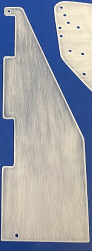

In regards to decorational prints / polycarbonate, one thing I would make sure of is that it can be easily taken off in the event that a referee believes it serves a functional purpose. This reduces any time loss that might occur in an event and can also prove to the referee that it serves no functional purpose if the robot performs the same.

Utilizing zipties can work fine, but we personally used 2-3 screws per plate that were attached with aluminum nuts for ease of removal. Doing so can ensure the decorational plates can be mounted securely and prevent it from getting in the way of more functional aspects of the robot. You can see what I’m talking about in the images below:
