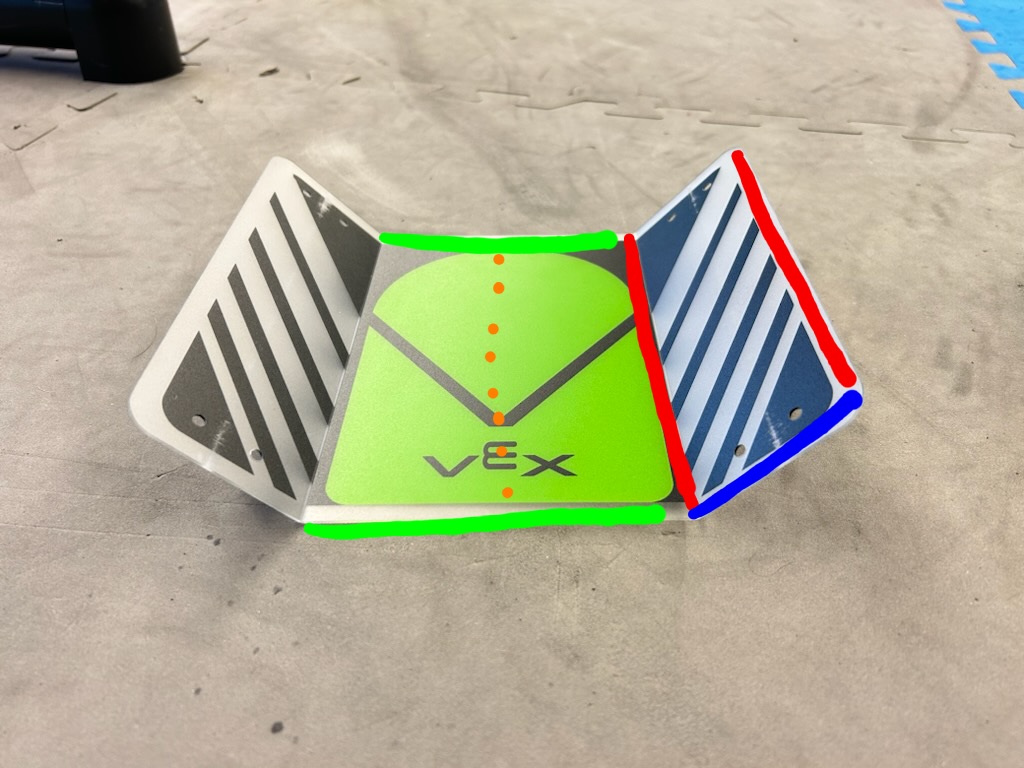

Legality of pre bent plexi glass
Dimensions
8in long edge red line
4.3/4 short edge green
2.5 slant edge blue
1.3/4 height
The peice will get cut and acording to the area of the peice we believe that this should be legal woth the slant but we would liek a ref or official to ensure us incase we get questioned about this.
Our question is, with this peice cut in half (across orange dots) can we have the (in guessing) 45 degree angle and not have to cut it off.

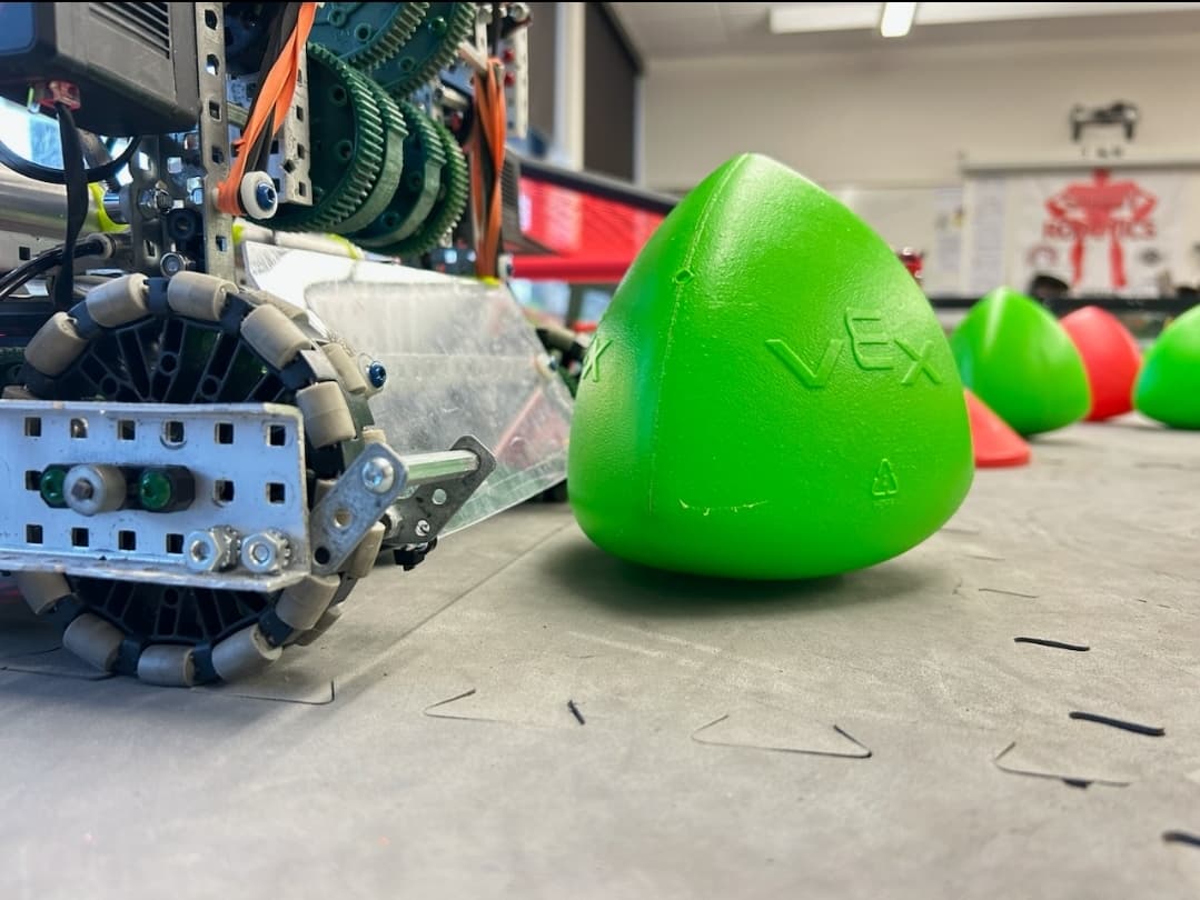

How we will be useing them is similar to picture 2 with the clear plastic
