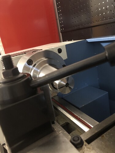

One thing, when I attempted to turn a HS shaft I ran into the issue that it’s hard to squarely put a square shaft in a 3-way vice. Other than that I see no flaws with this plan.
Yep, square stock needs either a 4-jaw chuck, or use of a square-stock (https://www.mscdirect.com/product/details/69744720) collet (most commercial lathes can use 5C collets, I don’t know about the miniature “educational” lathes.). There is a possibility, although I haven’t tried it, that the HS axle stock would fit a 19/64" collet (https://www.mscdirect.com/product/details/09740192), since the VEX square stock uses the “thunderhex” concept, that is, fully round corners. (see the VEX pro pages for more information).

(disclaimer- the collet in the pic is 5/16” and for round stock and not what i use for turning hs shafts. u want a 4 jaw chuck or 1/4” square collet for that purpose as was mentioned earlier)

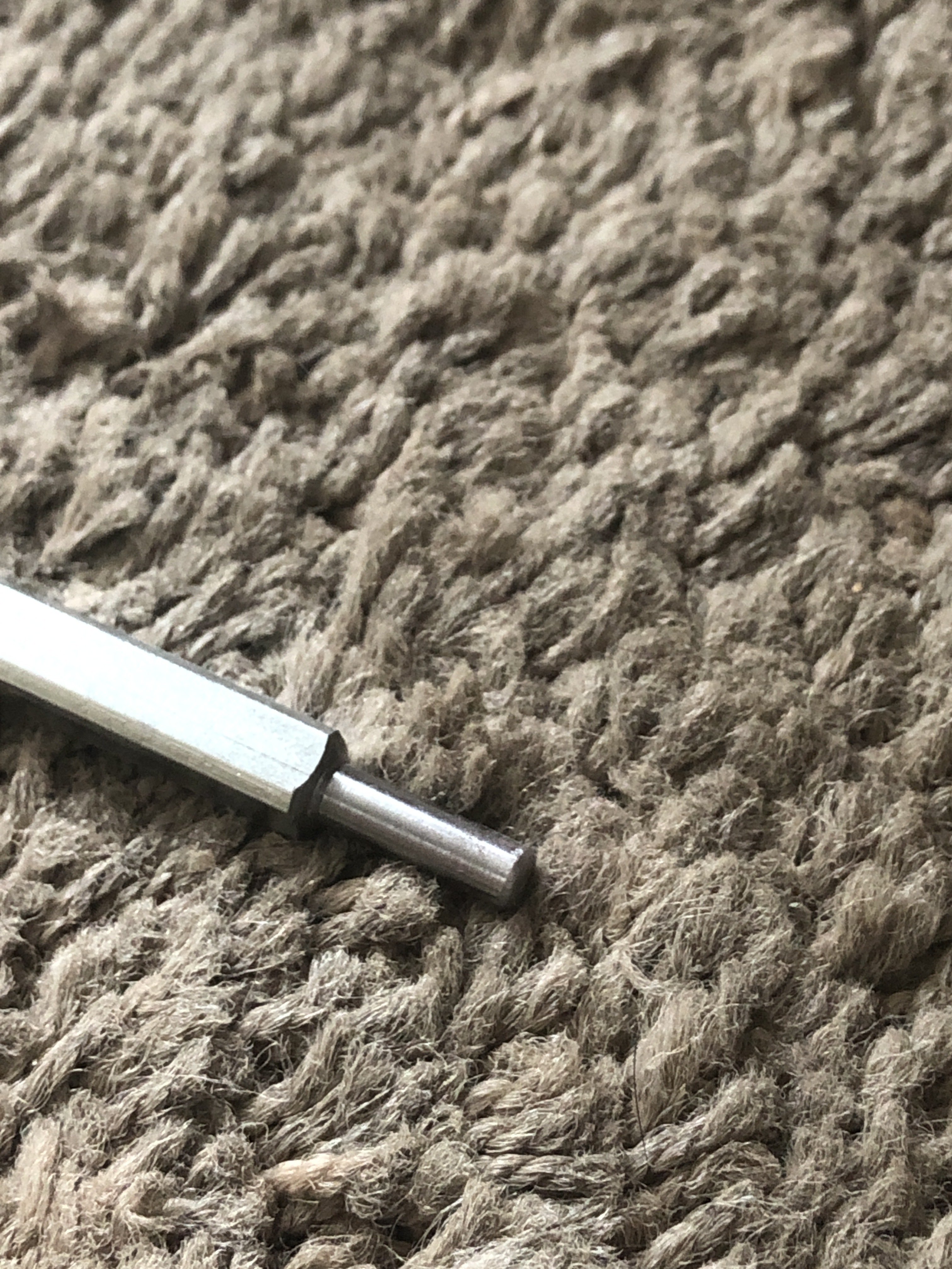

Can you post some pictures of parts turned from his shafts? I would really like to see them.

@Ethan5956F - Ping to see how the shafts turned out.
oh i completely forgot about this tbh. i made a lil step down on this one here so it can spin super smooth in a bearing but idt i did any testing with it lol
