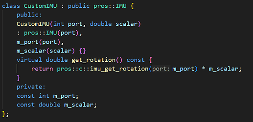

LemLib has been working great this season, and I encountered quite an interesting issue.
I had to make a duplicate Pros Imu class with a scalar to feed Lemlib corrected Imu measurements. This was to account for a very consistent undershoot in the imu measurements. After a few rotations, the IMU would be out by 5-10 degrees.
