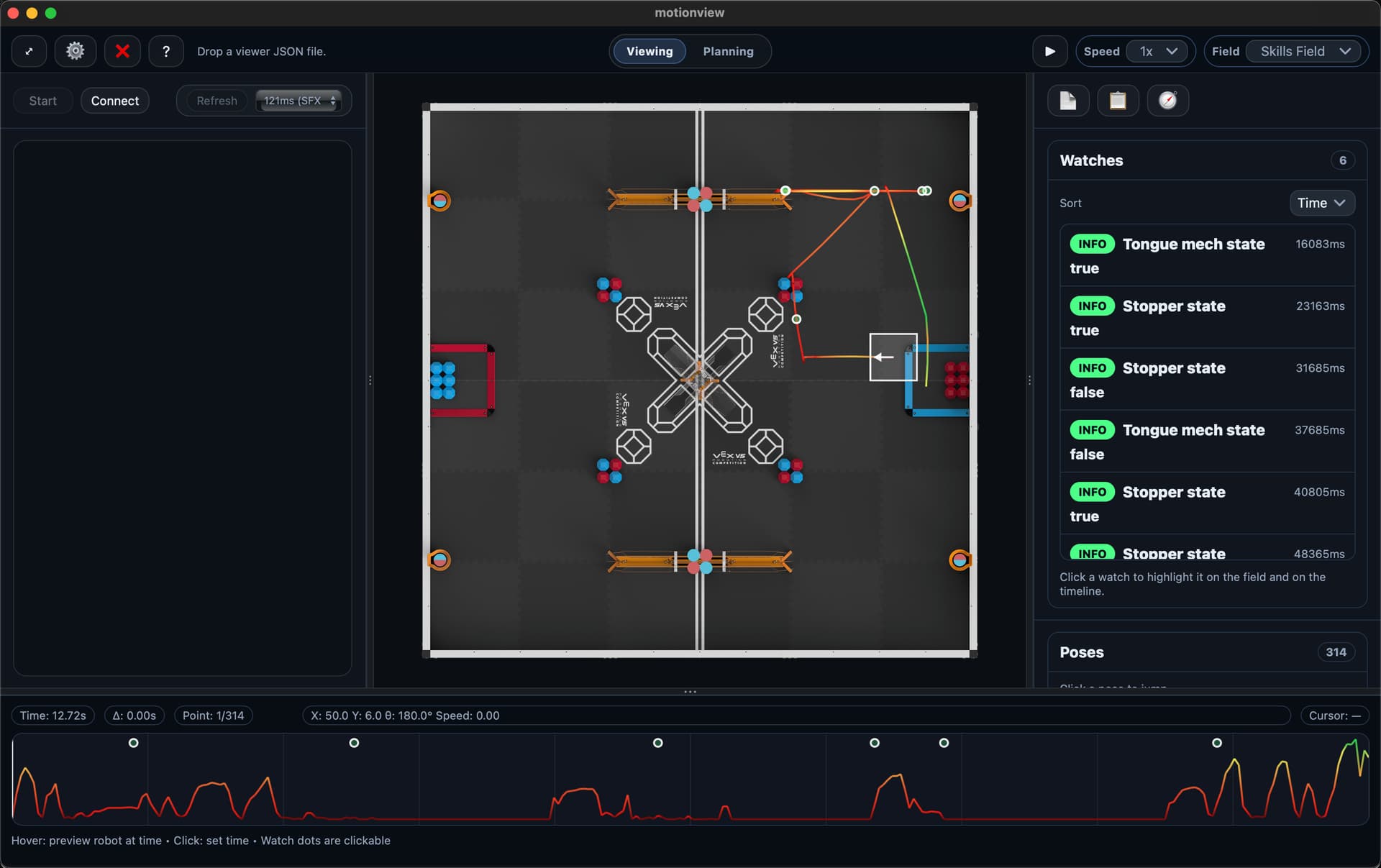

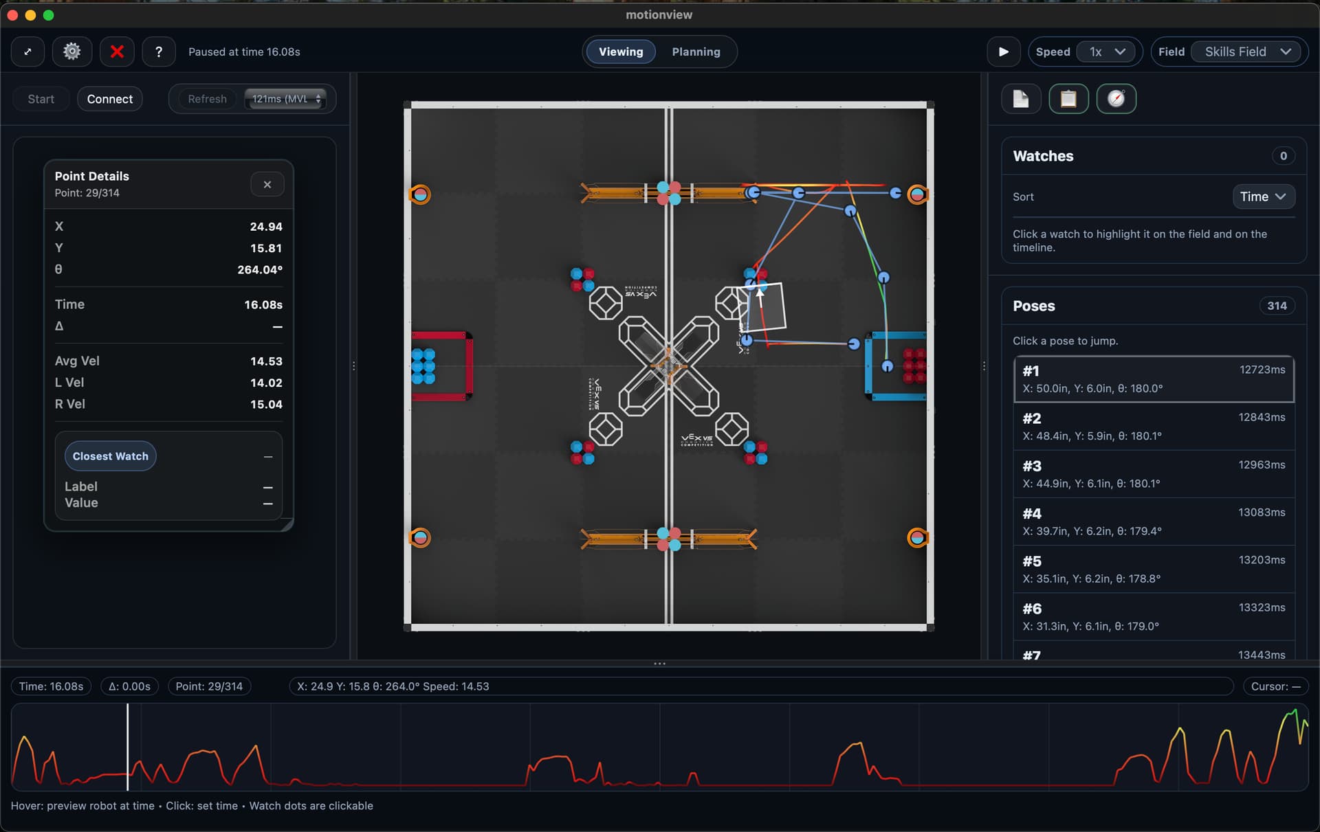

Viewing Mode (Run Playback)
Click here to view the image.
Shows a recorded autonomous run with:
  • The robot path drawn on the field
  • Pose readouts
  • Active watches listed on the side
  • Hovering on the path to inspect values at that moment
This run is a real recorded run from my robot in the VEX Pushback competition.

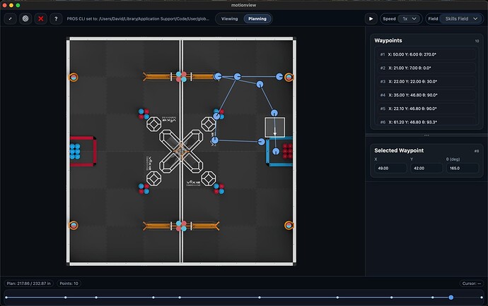

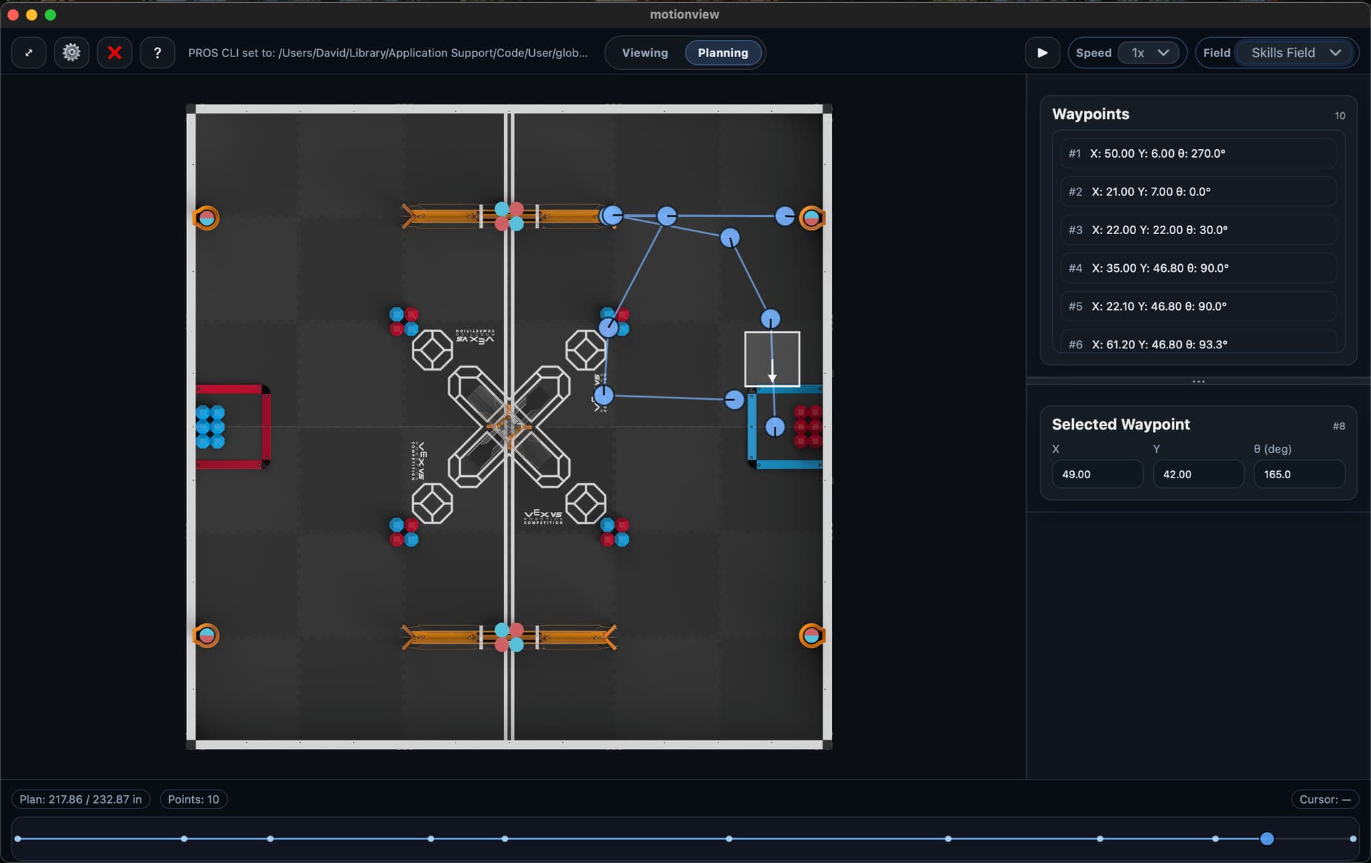

Screenshot 2 — Planning Mode
Shows MotionView’s planning mode, where:
  • Paths can be laid out visually
  • Geometry and heading changes are previewed
  • Planned paths are separate from recorded runs

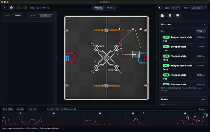

Screenshot 3 — Overlay Mode (Planning + Real Run)
Shows a planned path overlaid on a real autonomous run, making it easy to:
  • See drift or error
  • Compare intended vs actual motion
  • Tune odometry and control

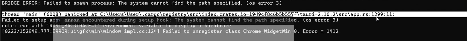

I tried installing this using the installer and it crashed immediately upon opening. I installed it on Windows, I’ve tried reinstalling it several times.
Thank you for bringing this to my attention.
The crash is because the app could not find the backend script (motionview-py) that manages livestreaming. I belive I fixed this with release v0.1.1. Please re-download, and uninstall before re-installing.
If you want to see the back end logs of the app, they are in: /Users/<yourUser>/AppData/Roaming/com.motionview.motionview
