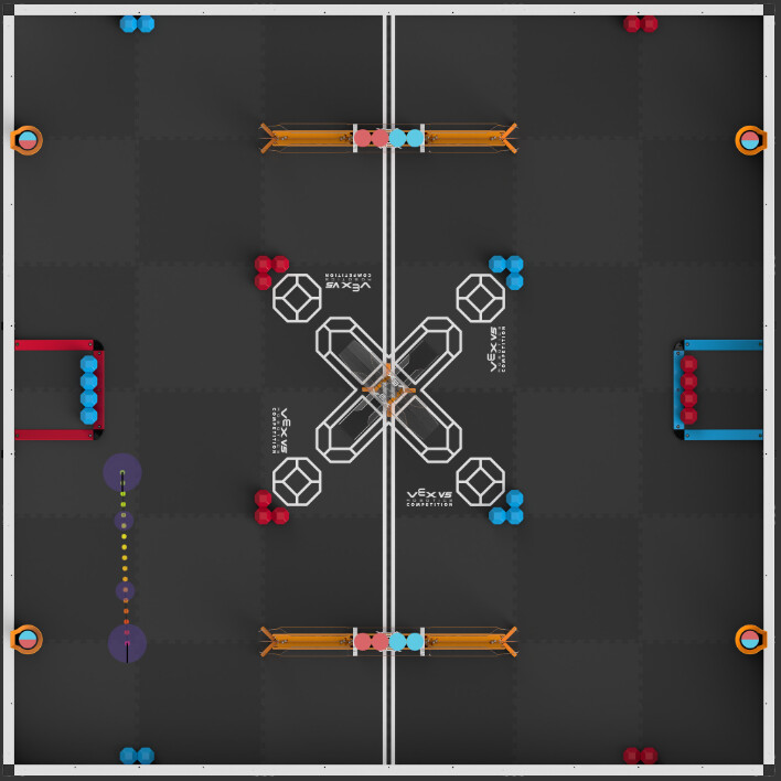

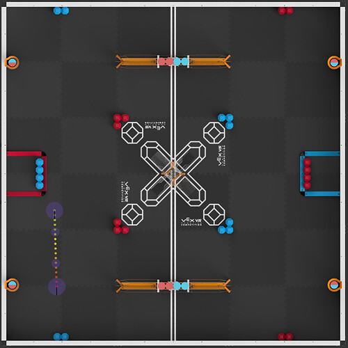

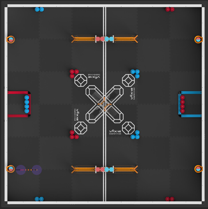

Whenever the code runs, it just has spasms at the starting position while the pneumatic and intake functions work correctly. I have tried a plethora of diffrent solutions, and none have worked. It could also just be me being incompetent when it comes to programming in PROS.
void autonomous(){
	chassis.setBrakeMode(pros::E_MOTOR_BRAKE_HOLD);
	chassis.setPose(49, -15, 180);
	chassis.moveToPose(-49, -47, 180, 5000);
	chassis.waitUntilDone();
	PnLoader.set_value(true);
	chassis.moveToPose(-60, -47, 270, 5000);
	chassis.cancelAllMotions();
	IntakeFunc(Intake::Suck, Output::Pass);
	pros::delay(4000);
	IntakeFunc(Intake::Brake, Output::Pass);
