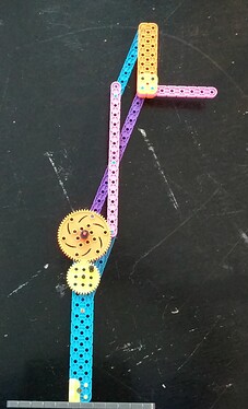

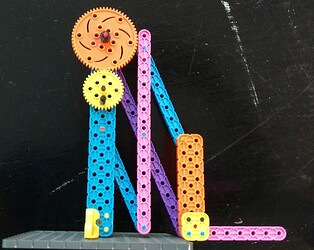

Non-symmetrical 6 bar. In robotics we usually try to make our 4 bar and 6 bar linkages symmetrical. And it is important that new teams start out this way. But if you were to look up “six bar linkage” in Wikipedia those mechanisms don’t look anything like what we are used to. The beams can be all different lengths and attached at odd points. Here is an example of you what can do with a 6 bar just by changing the geometry slightly.

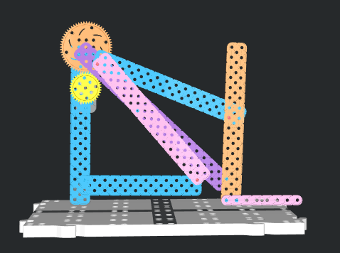

Normal 6 Bar:
Non-symmetrical 6 bar:
Down
Half

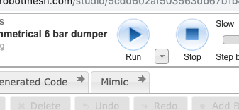

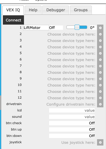

You might be asking yourself why you would want something like this. Click here to open a sample model made in RobotMesh Studio as a mimic.
I haven’t tried sharing anything like this before, so please let me know if it doesn’t work. When you first open the project your screen should look like this:
Click on the Mimic tab to see the 3D model:
38%20AM
Then press the Run button:
24%20AM
On the right of the screen you should see a list of devices that is mostly empty:

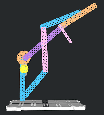

Note that gravity will pull the lift down to the starting position. Now use the slider control to the right of the “Lift Motor” to control the motor speed in the model:
53%20AM
Move the slider to the left slightly to set the motor speed to Reverse 20:
06%20AM
The block should slide off the front of the model when the lift is almost fully extended.
So a lift like this might be useful for a forward facing high dump truck. This is just one example, moving the placement of the connector pins or changing the lengths of any of the beams changes the whole motion. Endless possibilities.

I’ve shown that vid to my kids, very helpful, good energy.
Mimic works, your description how to access is perfect. Lotsa gravity, not much friction in that world !!!
