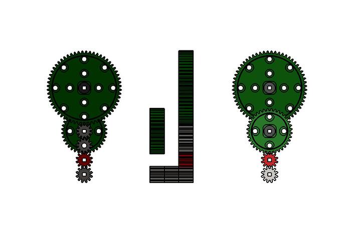

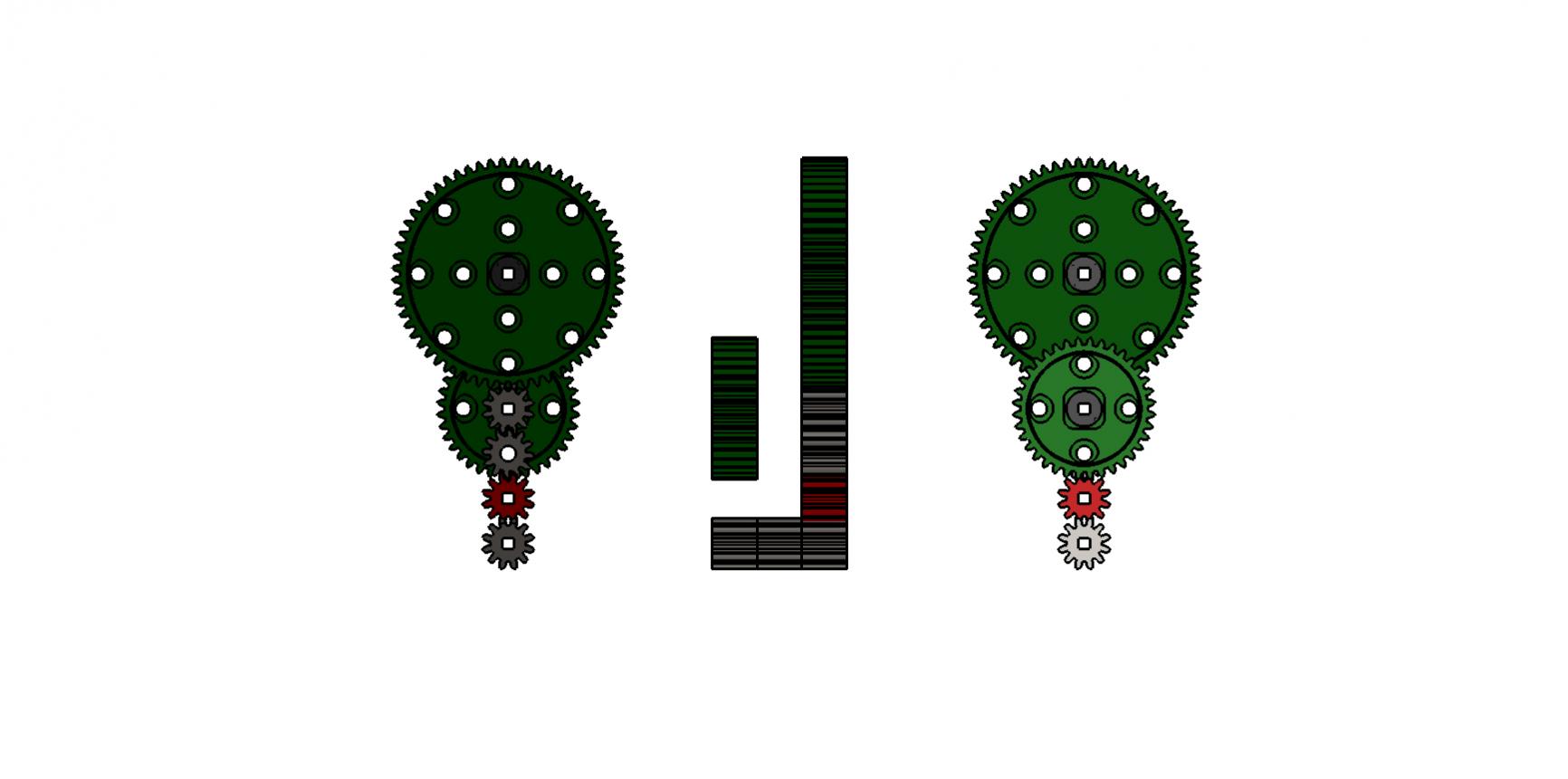

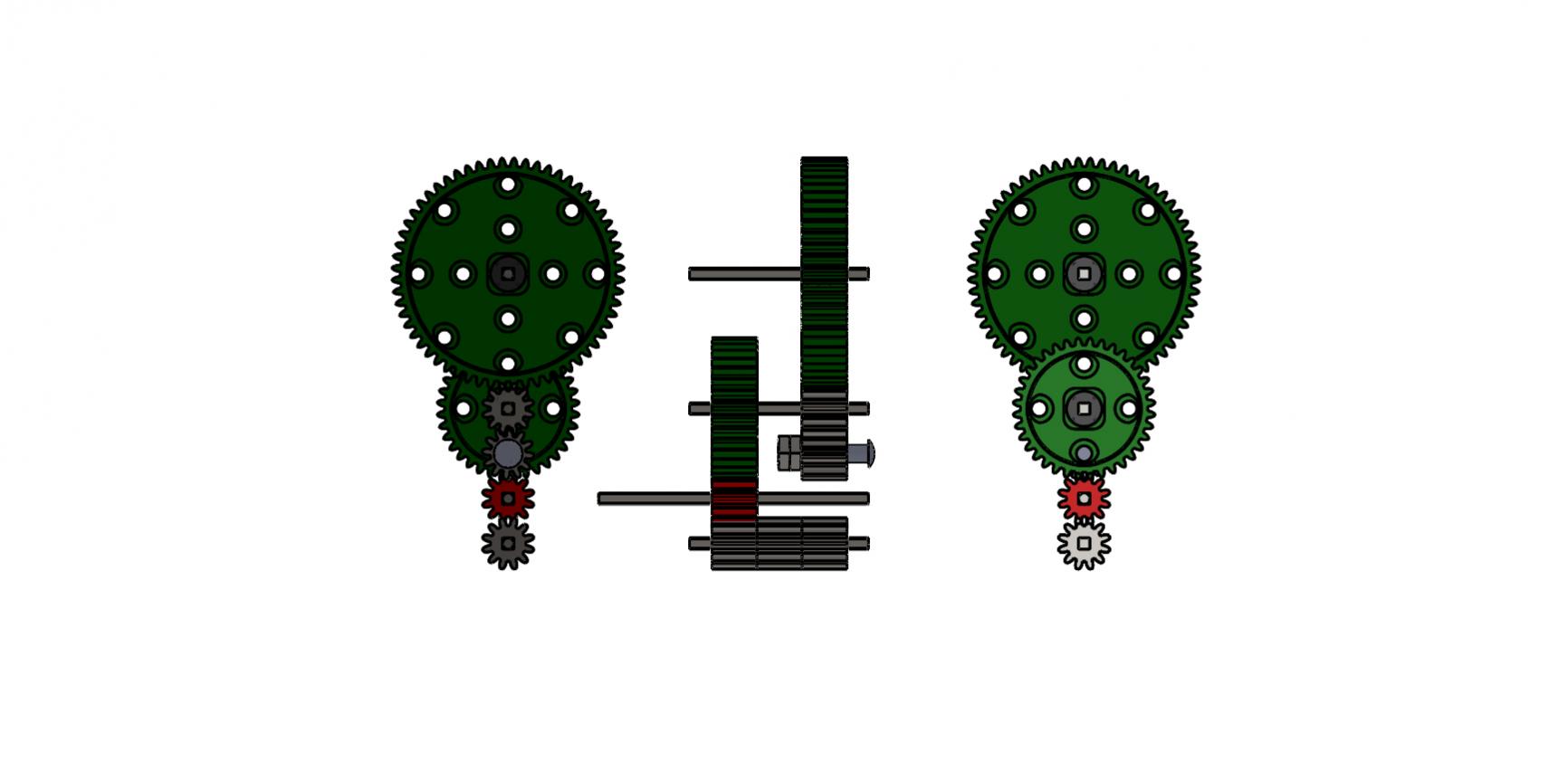

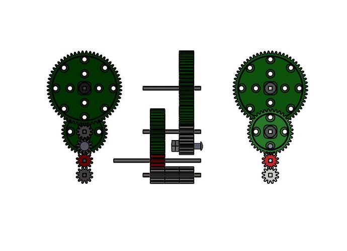

Here’s a picture of our transmission if anyone is interested:
Great. Thanks for the pic.
The metal to support the gears get in the way of the shifting gear by the way.
The center of the gear you are referring has to be drilled out and then a screw is fastened to the supporting metal and used as a shaft. In doing this it no longer needs support between the 12 and 36 tooth gears. Then on this screw-shaft I would recommend the following: a Teflon washer, the 12 tooth gear, another Teflon washer, and a nylon lock nut to act as a collar.
Shafts (and screw) have been included in the model below.
How well aligned do the gears stay? Does it shift smoothly, or are the gears ever misaligned to the point where it catches on itself while shifting?
I did not make this exact transmission, but I have a variation of it on my robot now and I have been very pleased with it. It can ‘catch on itself while shifting’ on occasion. When this happens a slight turn of the shaft fixes the problem and the transmission will become uncaught.
If ‘catching on itself’ becomes a problem a potentiometer or two limit switches can be used to track the position of the shifting mechanism as it shifts and correct the catching as it happens.
As far as gear alignment goes it’s just the same as any other gearbox made from VEX parts. Drilling out the 12 tooth gear is essentially the same as putting plastic inserts into a 36 or 60 tooth high strength gear.
