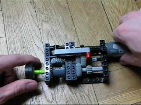

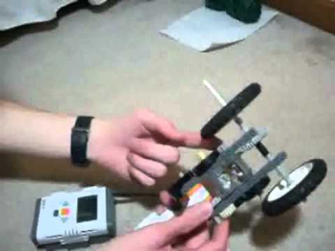

Instead of a motor or pneumatics activating a transmission, is it possible that you could have some mechanism that automatically changes gears once the robot is at the right speed, like a centrifugal governor or something of the sort?
Yes, that is certainly possible. Here are some LEGO examples demonstrating automatic transmissions:
However, while looking very impressive, some of those transmissions are not very efficient, wasting portion of the energy to friction.
Depending on the specific application, you could either prefer to have transmission shift automatically with the change in the load or control when shift happens by running some of the motors in opposite direction -that’s what I had in mind for the exercise in OP.

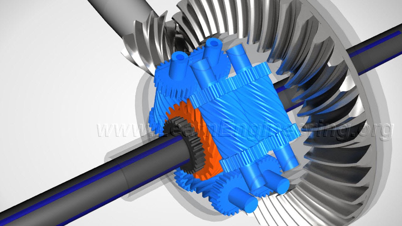

On the left is a classic differential and on the right is an alternative implementation of the same functionality. Believe it or not, but the differential in the following video, built by Stanley Shi and linked in many threads, offers exactly the same functionality, just with different parts.
Since there is no ring gear in VEX, it cleverly substitutes it with chain, but it is still just a differential.

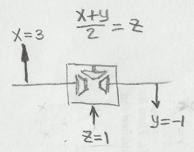

The fundamental property of any differential with three mechanical inputs/outputs is that the sum of the changes over them always holds constant.
For example, if differential casing runs forward with angular velocity z=1 and the right side runs backward with y=1 then the left side will run forward with the velocity x=3, according to the formula (x+y)/2=z for a symmetrical differential. Even if you build something asymmetrical that would be obeying a formula 5x+3y=z you could still consider it a differential…
The angular velocity of the inputs are relatively easy to understand, but relationship between torques applied to differential inputs is a bit tricky.

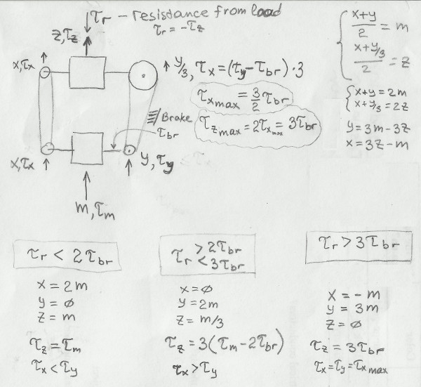

Now lets look at the following example of the double-differential “transmission” popular among Lego enthusiasts. There are a couple of videos of similar designs linked earlier in the thread. They are claiming to be multi-speed fully automatic transmissions. Unfortunately, they are not. I have analysed several designs and, even though they appear to “switch gears” under load, none of them offer more torque versus what you would have if you just used direct drive.
There are usually two differentials linking motor with the load through two power paths. On the above diagram left path is linked 1:1 and one on the right geared down 3:1. Also, the right side has some sort of friction pin or brake applied to it. There is a pair of linear equations for both differentials linking the velocities at various points: m, x, y, z. Where (m) corresponds to the motor and (z) to the output.
Tz = -Tr is the output torque to drive the load and Tbr is the breaking torque of the friction pin as measured at the right side of the bottom differential.
If load is very light the power flows through the 1:1 path on the left and output runs at z=m, x=2m, y=0. Then if output resistance (Tr) grows beyond a certain torque level (Tr > 2*Tbr), the right side path will have less resistance than the left side (Tx>Ty). The left side will stop (x=0) and the right side will start rotating delivering some power (y=2m) to the output (z=m/3).
As counter-intuitive as it is, the left side stops (x=0) because the torque Tx=3(Ty-Tbr) reflected through the top differential down to the left side of the bottom differential is greater than torque that motor is pushing into the right side (Tx>Ty). If torques on the two output sides of the differential do not match - only the weaker one will be driven.
Finally, if the load resistance (Tr) grows even further this drivetrain will no longer be able to drive it, because it max output torque (Tz max) is limited as it is related to Tbr. Then motor will simply circulate x and y gears wasting its power counteracting friction Tbr.

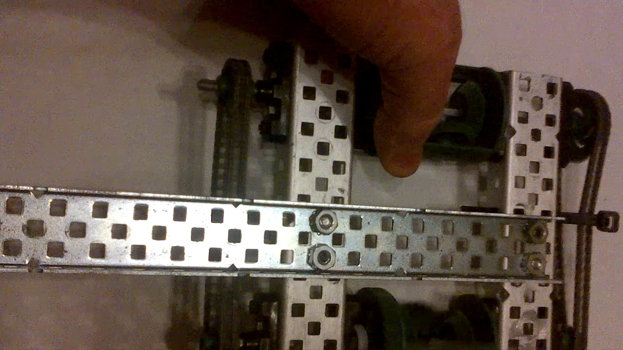

Here is a video of the prototype demonstrating demonstrating how it operates through the three different modes of operation:
The brake (a piece of zip-tie) touching the right chain is not very good as it still moves a bit - pretend it stays still at the beginning of the video. Then around 0:06 when I start holding the output (casing of the top differential) the left chain stops and the “transmission” enters low speed mode. Finally, as output is completely stopped you could see both both chains run fast. There is clearly much more torque available from the motor that it takes to stop the output.
Even on the paper if you try to pick a value for Tbr or change gear ratio you still could not get output torque to be greater than max motor torque, according to the formulas. Direct drive will deliver much better results than any friction based “transmission”.

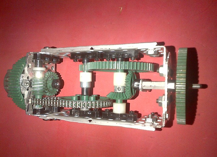

For those who are not jumping on the latest trend of the lightweight clawbots and are sticking with building heavy pushbots, especially 50 lbs and up, this reveal may come handy:
This is a fully automatic two-speed transmission that could operate in either high-speed or high-torque mode with 3x multiplier. For example, if you power it by three turbo motors it could deliver either turbo speed with the combined torque of 3 motors or torque equivalent to 9 turbo motors at 1/3 of the speed.
In this setup, two motors on the left provide 2T torque, while the steering motor on the right either adds 1T torque, if run forward, or adds 2x speed at the expense of 1T torque if it is run in the opposite direction.
It is built around a non-backdriveable differential where power could easily flow from the input shaft (on the right) to the output shaft (on the left), but the worm gear prevents large output resistance torque from backdriving the steering motor.
As opposed to the design described in the previous post, it is a compact version that has worm wheel and gear assembly riding inside the differential casing. Majority of the explanations from the above still apply, but the most important difference would be that forces which are transmitted by the worm gear are limited to 3T (vs 6T in prev example). Here is a more detailed picture:
With the combination of 5:1 gears and 48:10 chain link prior to 1:24 worm gear it achieves a perfect 1:1 ratio. Similar to the challenges of the flywheels last year, increasing speed 24 times requires a lot of attention paid to the friction. It took quite a while to figure out right spacing and alignment to minimize it.
However, once alignment was done and all high speed parts lubricated - it runs very smoothly. In fact, at this point, there is an opposite problem - the friction between worm wheel and worm gear is so low that differential could fail to lock if steering motor runs forward faster than the pair of the power motors. Control algorithm needs to take this into account and match steering motor speed to achieve reliable locking.
Contrary to the common belief, the low-strength chain is not the weakest link in this implementation. If you manually increase output resistance and matching torque on the input side - worm gear would still be running smoothly, while the bevel gears were the first to skip. According to my estimates in the worst case scenario of three torque geared motors at the stalling, you could expect about 15 in-lbs of the load on the bevel gears and about 2.5 lbs of the linear force on the chain (well under its shock-load breaking point of about 5 lbs).
When dealing with any chain, to minimize impact of the the shock loads, you need to make sure it is neither loose nor have any extra tension - it should be relaxed, but with very little free play.
In the initial testing everything seems to work great, but I still have doubts if worm wheel and gear are strong enough to endure continuous drivetrain load. My main concern now is if it will hold well under shock loads and not twist out of the alignment after some rough play, like running robot into a wall at full speed several times.

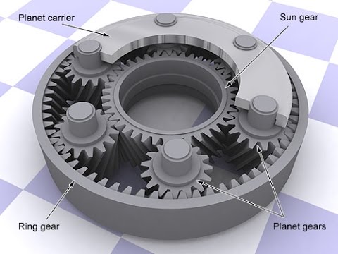

Planetary transmission built by @Stanley Shi(2R) is a classic differential. It could easily add contributions to the output speed from both input motors but the output torque is limited by the weaker input (which in the above example is motor connected to the outer chain). So without some sort of locking mechanism that can prevent backdriving of the weaker input you end up underutilizing max power available from your motors. This thread has some additional discussion: Planetary transmission: can this really provide the torque of 2 motors? - Technical Discussion - VEX Forum and eventually refers to this video with the locking example:
Without locking, by the time you add up all the numbers, it will turn out you would have been better off just linking both motors in the direct drive configuration and relying on MC29’s to be the electrical equivalent of CVT to regulate your output power/velocity.
So the key here is to lock. You could do the locking via external actuation by pneumatics or servos, as many successful shifting transmission do.
However, the design revealed in the previous post uses the property of the worm gear to self lock (by friction) when output load (torque) is above certain level.

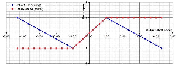

Now, lets take a look at the expected performance of the shifting and non-shifting transmissions as a function of the output load. Assume that we have three motors that could run at the nominal speed (1x) and generate torque up to (1T) each. Note that as the load on the motors increases, the output velocity decreases. Also, we are assuming that you do not push motors into the ranges where they will stall or overheat.
Blue lines correspond to the shifting transmission. In the high gear (top blue line) you are expected to get high speed around 3x and usable torque up to 1T. After transmission shifts, you would be getting 1x speed at 3T torque (blue line on the bottom). Shifting transmissions have virtually no overhead vs direct drive in either high or low gear modes.
In case of the worm-based transmission, there are additional friction losses in high speed mode (when worm drive runs), which is represented by the green and violet lines going down at the steeper slopes. You could still get high velocity, but the maximum torque available at the high speed will be reduced, because portion of the motor power needs to go toward the friction losses in the worm drive. The less friction losses there are - the higher output torque you could get.
When you switch into the low gear (high-torque) mode the effect of the worm gear friction is the opposite. If you have too little friction in the worm drive, then combination of the load resistance from the output shaft and the torque coming from the steering motor could break the static friction lock and let the output shaft slide below 1x output velocity. According to my calculations if you have friction coefficient as low as 0.05 you will be limited to 2T torque coming from the power motors and couldn’t get additional 1T from the steering motor.
Depending on the amount of the friction in the worm drive you could have less than ideal torque performance in either high speed or high torque mode.

Now, I would like to counter the precision arguments. VEX robots could have much higher precision, than most people believe, if you use certain tricks. For example, I built this demonstration prototype optimizing it for lots of open space that makes it easy to see and understand its inner-workings. Most spacers are on the shafts and it is true that one washer thickness is the best precision you seem to get:
However, if you turn it around and manage spacing adjustments by bringing supporting structures closer or further apart, then you could get much tighter tolerances with these tricks:
  1. Hammer standard metal or teflon washers to be thinner.
  2. File off or hammer aluminum flat pieces to fractional thickness.
  3. When even better tolerances are necessary, you could insert a thick white spacer and vary its compression with tightening screws.
Also, you may need to use double nuts and/or thread locker to fix your parts in place.
Once some of those tricks were applied everybody were quite surprised of the improvements in the build quality.
