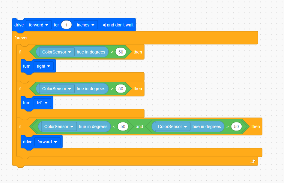

Here is something I had played around with. I copied the program from when I used Modkit and rewrote it in Blocks.
When, I used Modkit the robot actually turned right when I put in a turn right command . What’s missing is how far to turn right. This is why I used that command in Blocks. But, I discovered through other projects that Blocks doesn’t act quite the same as Modkit.
I just put in color degrees as a sample to look at…and yes, it says 1". I never ran it because I realized that it would travel only 1" and then read the line. If it was successful then it would continue for ever. Maybe?

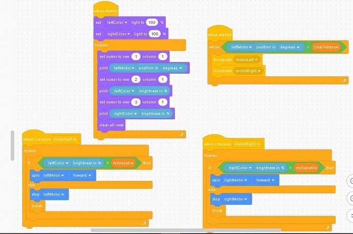

What you can do in order to travel a certain distance while following this method is using your motor encoder. Your motor encoder travels in degrees, so you would need to measure how many degrees it takes for you to reach your destination, that is why I put it in the print so that you can see it.
I also made a few changes to my code, because I realized my last example did not work, at least for the color sensor part.
P.S. Guide yourself off one motor, because both motors register different degree values.
Yes, it would run forever. I like how you are doing with drive train. I might with it today to see if it works. We can have our students doing drive train instead of two motors, since its a bit easier.

Thank you for your help. The robot will travel forward a certain distance. What I can’t wrap my brain around is how to code it to make it go that distance and follow the line. I can program it (when I have accessibility to my stuff in my classroom) to either use one or two sensors and go forward. But, it will just go forward indefinitely.
For example, if I go forward 5 turns. It will go forward 5 turns but, not read the line following code as it moves forward. I want it to do both. This is where I am lost.

It’s actually not easy using the Drivetrain because the only data you can get is from the Drivetrain gyro, not from the Drivertrain encoders. If you used separate motors instead of a drive train, you could then “repeat while encoder is < however far you want to go”.
I’m not planning on using a drive train. I’ll try the repeat.
So, repeat (enter line follower program), while travelling X distance?
