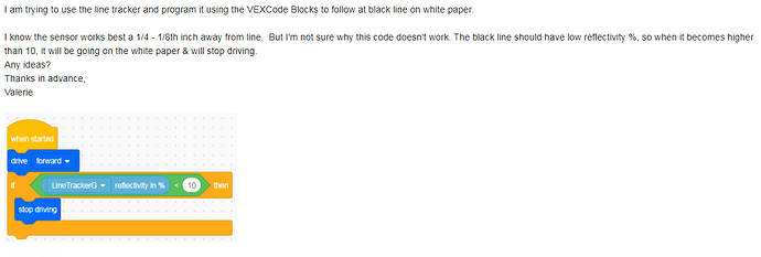

Line Tracker sensor using V5 Robots & VEXCode Blocks for coding
You should use a wait until instead of an if.
Ok. I will replace the if with a wait until and see if that works. Thank you!
It should be > not <
Thanks, II changed it from < to >… So either way, if I am going from white to black or black to white, what ever the threshold are, my sensor doesn’t see to be working. Have you been successful at using the line tracker?
I have had it print the value to the screen and its zero “0”. Not sure why the value doesn’t change.

I’ve used it a while back. Try looking at the Device Manager in the brain and see what values it displays. It might be some initialization error or a dead port or a broken line sensor or wiring issue.
I will check that, thanks so much!
