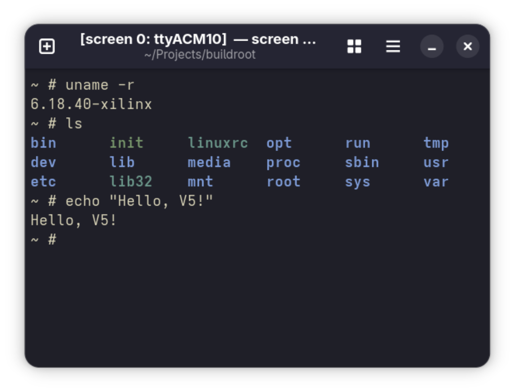

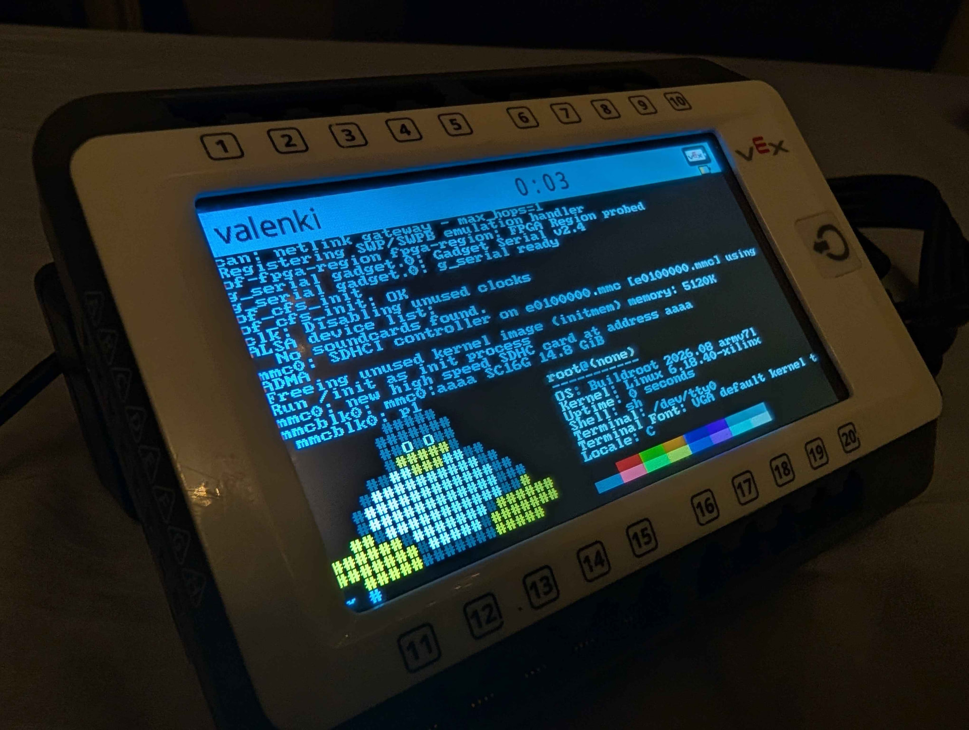

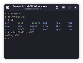

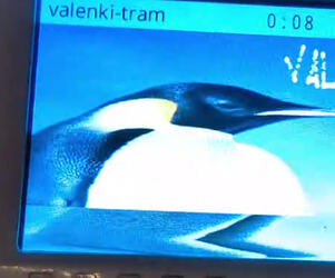

This is Linux 6.18.40-xilinx fully booted and running from a V5 user program.
Doing this has been a goal of mine for quite some time, and I was never completely sure if this is possible. My first attempt at doing this (around a year ago) failed terribly for a number of reasons I won’t go into.
Do not try this at home, I’ve intentionally chosen not to release this project in full due to concerns that people will accidentally destroy their hardware.
How?
Most hardware inside the Brain has decent mainline Linux support. The largest hurdle is working with (or around) the existing environment VEXos has setup. This meant writing a custom ARM linux bootloader inside of a user program, which I unfortunately won’t releasing to the public due to some sensitive implementation details and concerns that it could damage someone’s hardware.
The kernel itself was built using Buildroot using a custom device tree and a lot of configuration tweaks. Getting past early initialization was utterly miserable. I was essentially working blind, since there is no way to get logs or any feedback off the Brain after the kernel starts booting. That alone was nearly two weeks of effort.
What works
  • Display (via fbcon)
  • USB (Host, OTG, and Gadget mode, yes I can plug a keyboard into my Brain)
  • SDHCI Controller (sdcard)
  • Interrupts and clocks and such.
This all runs in RAM and will be wiped once the Brain loses power. I wouldn’t dare try and persist this.
Why would you ever want to do this?
idk, seemed cool, okay bye!!

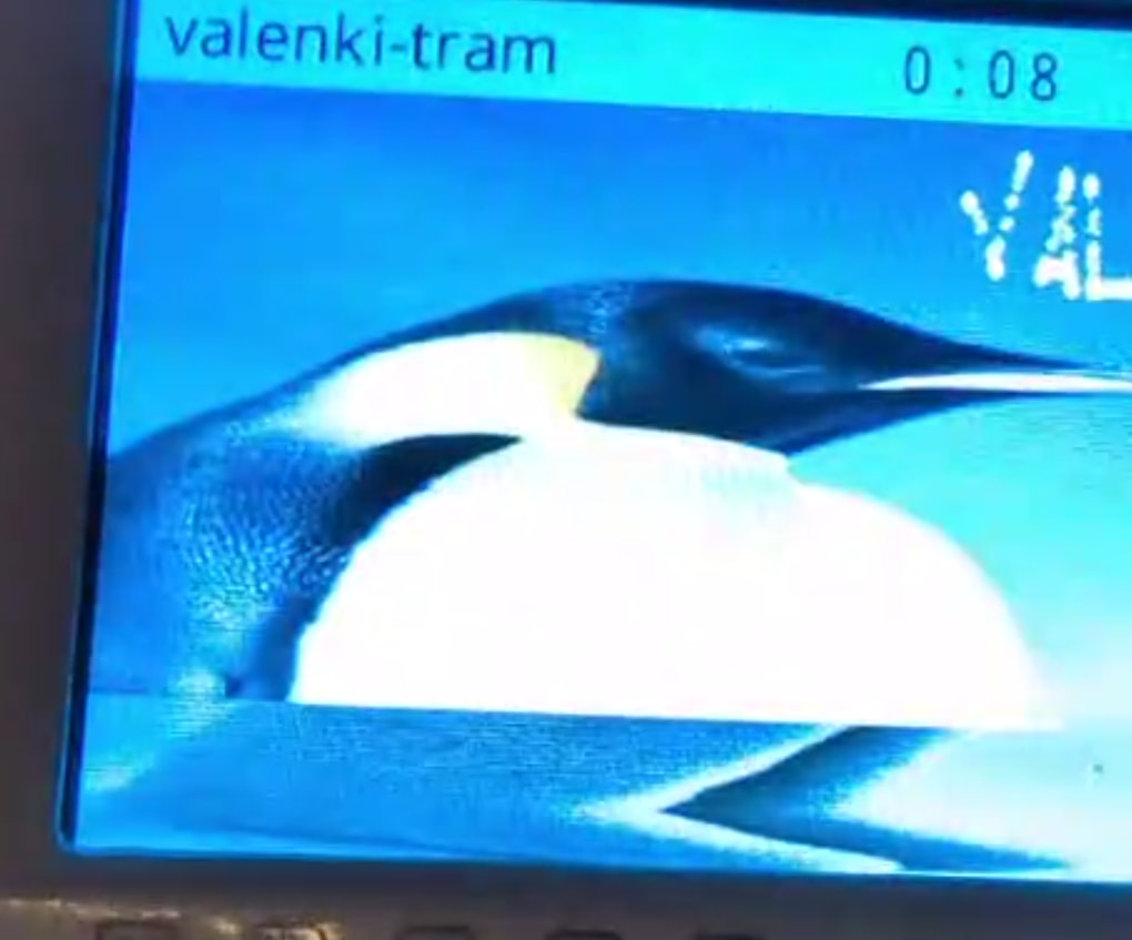

As James said, DOOM has already been done. That being said, I have gotten a DRM/KMS (direct rendering manager) driver working since I made this post (minus vsync support due to quirks in how the Brain routes interrupts not playing nicely with the kernel). I’ve been able to test some basic graphical apps using a small wayland compositor written by by good friend Gavin, so i’ll let you know if DOOM ends up being playable here soon :>
Things have been going a little slowly since I made this post (been busy with other things) but my bucket list for this is roughly:
  • Get an X11 session running under something like openbox. This was giving me trouble previously due to not having a DRM-compatible video driver, but shouldn’t (?) be an issue now.
  • Connect a brain to the internet over a USB Wi-FI adapter.
  • Boot into a full Arch userspace using an SDCard as secondary storage/swap (people have done this on far worse hardware, so this should be possible I think).
