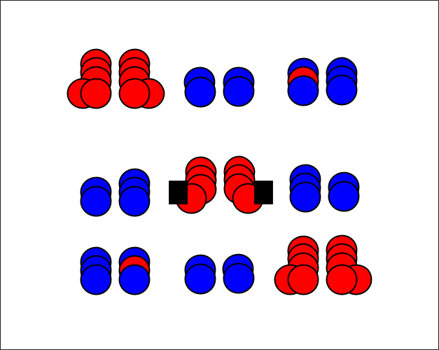

The “ideal” LRT match, assuming you mean everyone plays perfectly, results in repeated ties. This is just an inherent flaw with the LRT scoring system for Change Up, and I don’t think there’s any way to make it better if we have to use this field and elements. This is because if you are unable to own any of the goals in a diagonal on the field, you cannot complete a single row. This means that by maxing out a diagonal, all you have to do is start by using your robot to hold a 4th ball in the center goal and double it, and if your opponent tries to double a corner, you just double that corner as well. Thus, everyone will make some variation of this combined alliance field in driver control (this is for red alliance):
Garunteed Win (2)
This wouldn’t be a problem if you couldn’t max auton, but since you’re restricted to half the field, and you only have 6 open spots but 5 balls of your color, you can max auton, and teams will. I wouldn’t be surprised if a BO3 LRT world finals goes upwards of 10 matches (assuming there are enough good teams that choose to do it instead of remote skills). Since you have a full 1:45 for driver, top tier matches will come down to whose auton messes up
