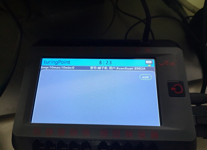

[LVGL] How to draw a rectangle using LVGL?
I try to use this function.
But he seems to be ineffective.

yes,I want to make a visual sensor recognition interface .

I want to make a visual sensor recognition interface, if you can not customize the drawing, then this function will not be able to achieve.
obj1 = lv_obj_create(lv_scr_act(), NULL);
I have a BTNM object on the outer layer that I can’t “use lv_scr_act()”

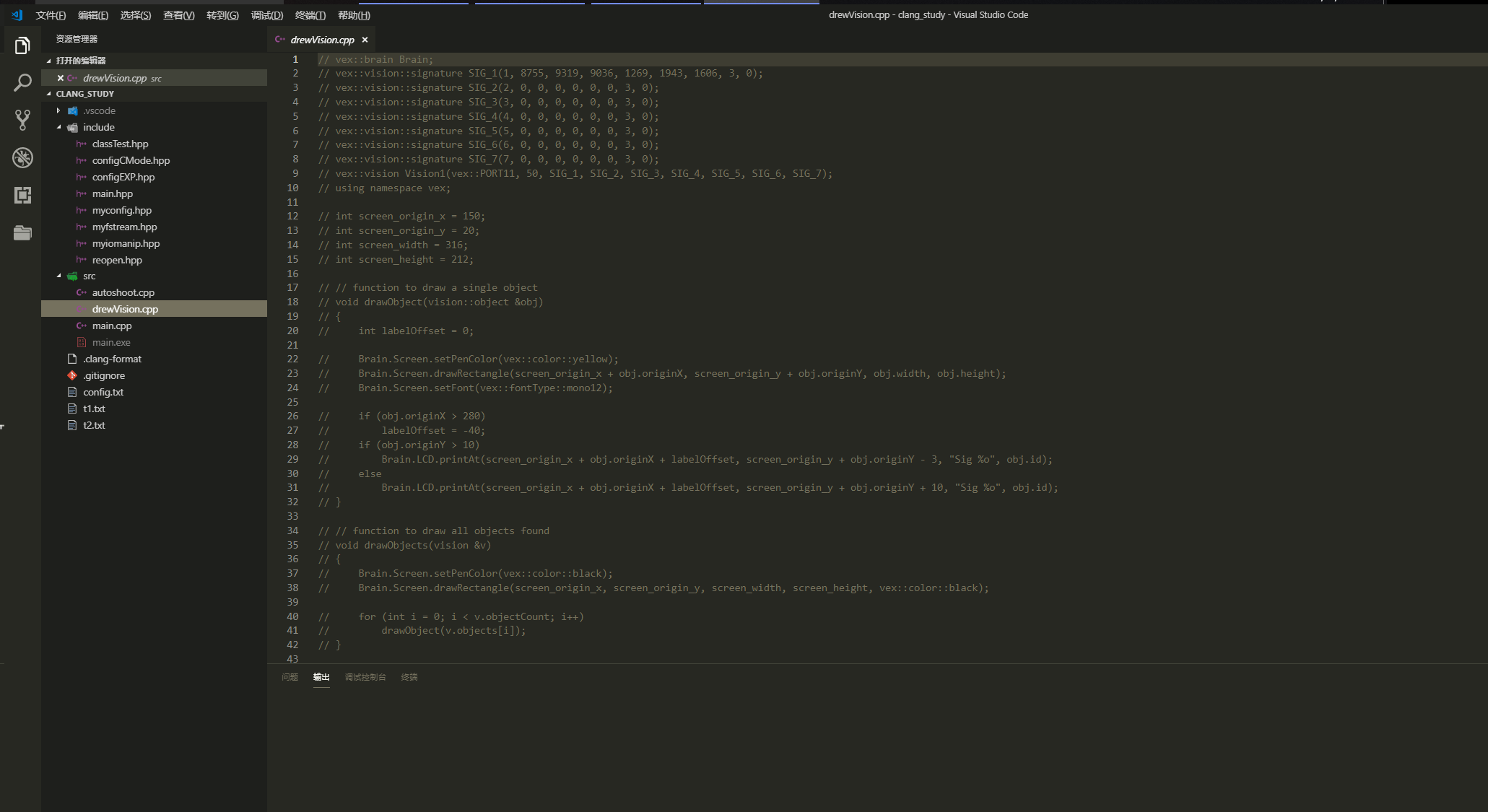

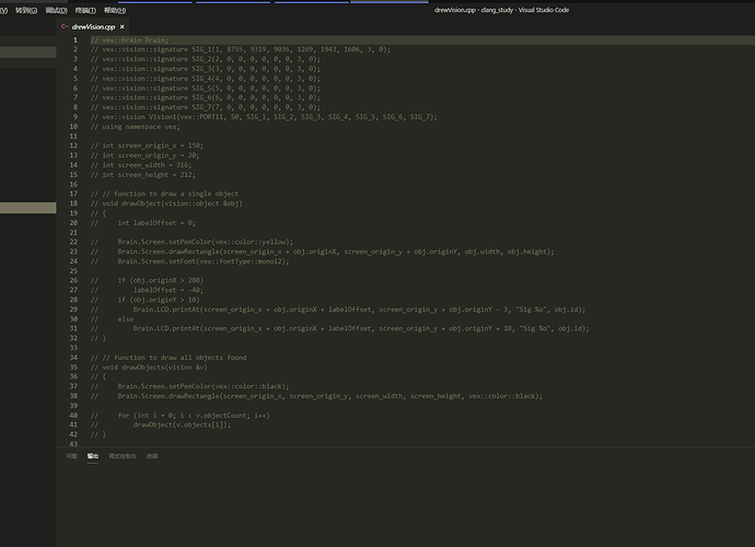

I want to transplant your visual test page on VCS to PROS.
this is you example code.
Then use the BTNM object as the parent.
@jpearman His plan is effective.
Thank you very much, too, for what your team has done for vexer.
