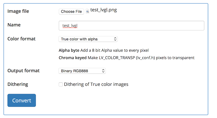

So I’m trying to make some imgbtns in LVGL using a micro SD card, but the imgbtns always just turn out as a white image that says “No data.” I’ve read that I need to set up a driver for LVGL to read the SD card, but I don’t know how to do this. Ultimately, I would like for it to pull images from S:/images/*.bin. Any advice?

It may have broken after the lvgl update to 5.3 that PROS did recently. Which image converter did you use ?
I used the old converter.
for the latest PROS kernel (3.2.0) I had to use the new image converter with these settings.
Yeah, I just tried the new converter with C arrays and it worked. I guess that this was the issue, not the driver.
