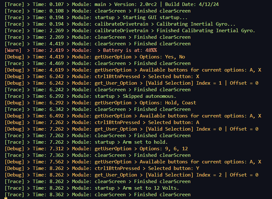

This is really cool!
I wanted to ask if you ever plan to have colored messages on the SD using rtf?
I had gotten colors when printing, but never on the SD card.
I’d love to see what your program prints out, I only see small screenshots.
I also did not see any level of errors, or modules as a suggestion.
This would be an example of what the error logfile would look like on the SD Card. The small screenshots were to show what each function could do, but they would all print out togetehr depending on which functions or used or which errors come up under auton or drive like this:
Or this for the data logfile:
Color for the text file is a great idea, and I will look into that.
Also, what do you mean by modules?
Thank you for the screenshots!
I meant a function name, so if I wanted to log a debug value in the function getUserOption, the log handler would also have that in the logs so that you or someone else can refer to what module that was in. (Look at my screenshot, it looks like this:
[Trace] > Time: 2.222 > Module: clearScreen > Finished clearscreen
You could have something else for the module and message but that’s all it is.
I would also suggest some spacing from the time and what your printing, like using |, or >, etc.
