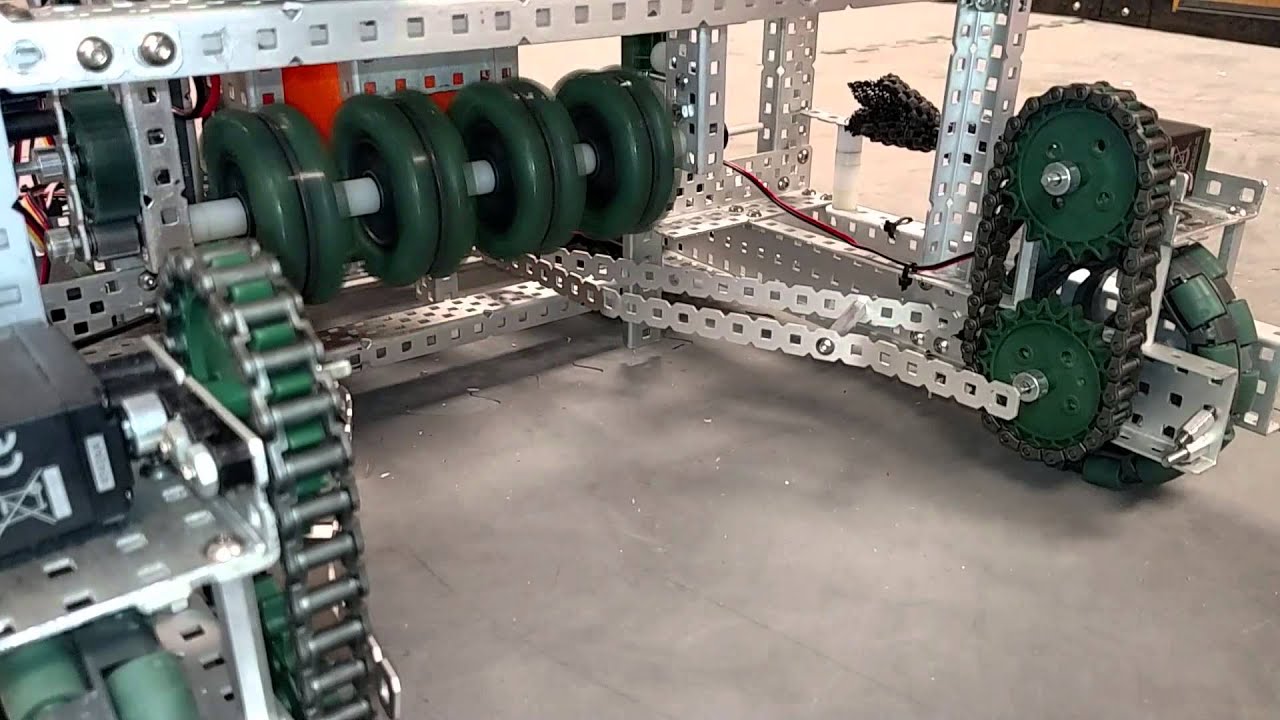

From my understanding, most pitching machines used a double flywheel to launch the ball.
Here’s a video of a double flywheel.
It is not by my team, but they are the team that popularised double flywheel in vex.

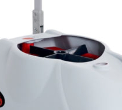

Hello everyone ,
My head is swimming with responses. Thank you all ! Servo, microprocessor are so far out of my realm. The pitching machine being used is a single wheel flywheel. My problem is in just releasing one ball at a time loaded in the troff to allow one ball to roll into the pitching machine by gravity. My thought was to maybe use just a retractable solenoid and get rid of my crude hinge, eyehook, pulley and rope. Using a wired momentary switch or some sort of wireless to activate solenoid to release a ball. Thoughts?

If you are looking at single flywheel, then you can’t go too wrong with this thread:
You will need to do some adaptations with the “intake” to some sort of a tray to hold the balls?

If you’re using any sort of contraption similar to Nothing But Net or Turning Point, then you’d probably need one last conveyor, indexer, before your flywheel. When coded right it’ll index one ball at a time. You can also automate it so when you push a button it’ll index one ball into your flywheel, and another ball will be loaded into your indexer.
Here’s an example of one (skip to 1:20), but it doesn’t have to be so complex. Hope this helps!
