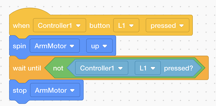

How do i get my motor to spin forward when I press L1 on the controller. I am using vex code v5 blocks. I am very confused.

What you’re actually asking is very simple…
Both of the following blocks would do the trick.
You probably wan the motor to stop if you let go of the button, or to stop as some other time. You will need to account for that.

Take a look at the “Controller Button” example project inside of VEXcode V5 Blocks. It uses a controller button event to trigger a motor and then stopped the motor when the controller button is released. Here’s a snippet:
Thank yall for helping I got it to work. I got the code to work and realized a very idiotic mistake. I had the motor code in the wrong port lol.

Would this work in competition? It’s not under a driver control event block. Wouldn’t this mean
it wont work during the driver control period?
