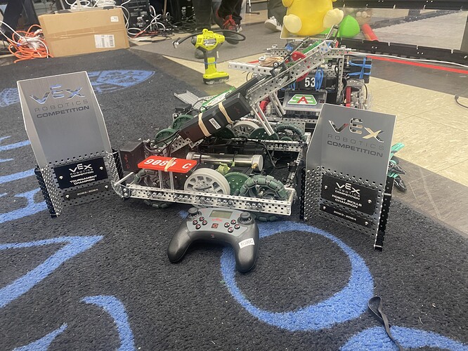

We’re a flat bot and it absolutely destroys the meta. All defensive play goes out the window.

Unfortunately we haven’t dove into the realm of reveals or media, so I can’t exactly show you the bot other than a picture. However, I’ll be glad to give some insight on strategy
Since flatbots make it risky to double zone, alliance partners and I double zone shoot, splitting them 10-12 or so. We start on the far side, and transition to the left of the field to shoot while our teammate takes the close side of the field and immediately starts. What usually happens is when the match starts, they shoot all of their triballs immediately and start scoring whilst we shoot and defend. If the opponents double zone to defend or attack, our alliance de-scores. This forces opponents to adapt and it makes it difficult to outscore us. It hasn’t failed us against metabots and we have other strategies for individual cases such as Qualifying Matches too, but it’s a bit complicated case by case.
I’ll give a small picture of the bot below.
