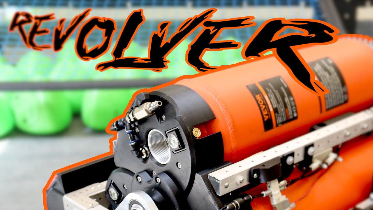

This robot is absolutely insane and I have seen it first hand. That thing is HUGE.
The Q&A outlawed PYRO descore😭

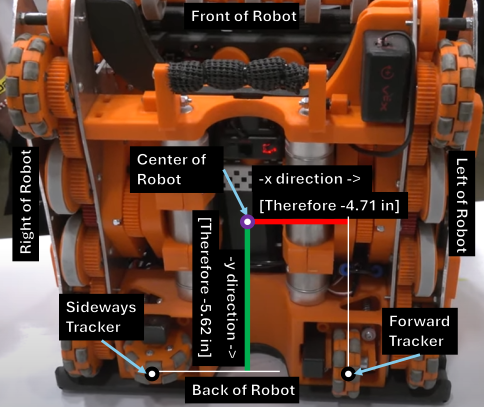

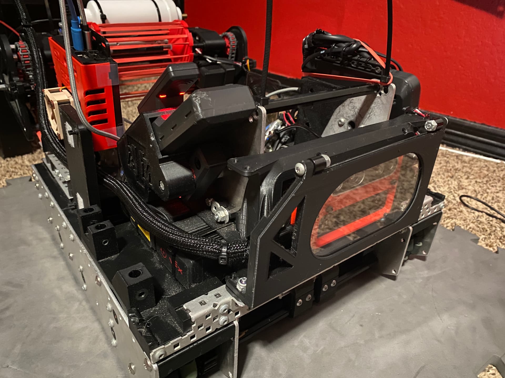

I have once built a VEXU robot with regular VRC C-Channels and found that the VEXU robots have a LOT more torque and power and may bend longer C-Channels during matches.
Realistically, I would recommend starting out your structure with CNCing sheet metal with 3D printed components structurally squished between the inner and outer sheet metal for each side of the chassis.
As you see, most of the VEXU robots tend to be simplistic, relying on 3D printed components and sheetmetal for the majority of the structure.
Are either of those yours?
Top picture is WHOOP, bottom is WISCO. First picture was a robot I worked on while I was in Aggie Robotics, while the bottom was from a FIRST Updates Now video on WISCO. Both robots were shown publicly at VEX Worlds.
The top robot was part of WHOOP, who fought against WISCO at VEX Worlds Division Semi-Finals that season. The second robot at the bottom is part of WISCO, who beat WHOOP in the Division Semi-Finals and later won VEX Worlds at the Dome for that season.
