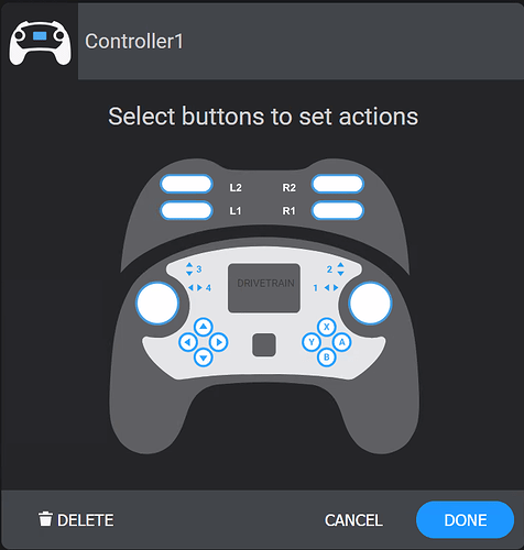

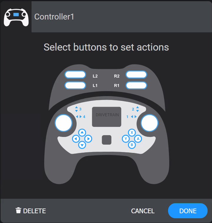

Mecanum code being weird, please help
Hey guys, so, I have mecanum code, and it’s being weird(as the title says). So, the controller configuration isn’t allowing me to map controls to the joysticks. Like, when I click the joysticks, nothing pops up, and I can’t map controls. Does anyone know what’s happening with this, and/or how to fix it? This is urgent.
Edit: It’s not a joystick issue, because it works with the preloaded drive codes.
Only the drivetrain motor group can be assigned to the joysticks. Motors have to individually be programmed if not part of the drivetrain motor group.
The controller isn’t set up so you can code mecanums by setting joysticks anyway. It assumes a tank drive.
I don’t know anything about the joystick setup thing in vexcode, but I highly recommend you just program your own drivetrain. This is both better for learning code, and also more flexible since it’ll allow you to add things like deadzones. It’s not too hard, and you can find tons of example codes on the forums
To code drivercontrol for mecanum base, I would recommend using the motor-command-with-stick-output-as-speed-value way as detailed in my previous post here.
Hope that helps, and good luck! :grin:
I’ve set each motor up individually, not in a drivetrain.
If you want I can put on a code for it tomorrow. Don’t feel like writing down the program at the moment.
You can if you want.
