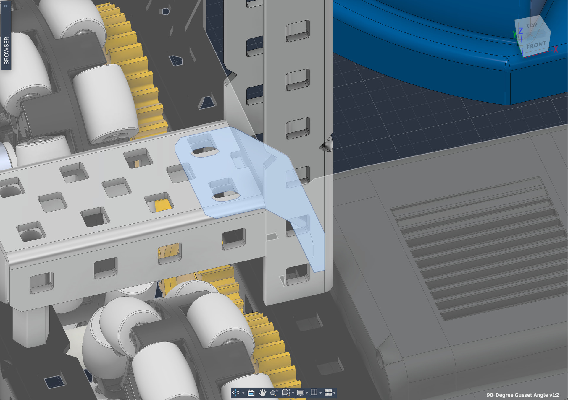

This image shows the current vertical C-Channel mount, but I want to know if there are other ways to mount it to make it more stable, other than adding diagonal bracing to the C-Channel.

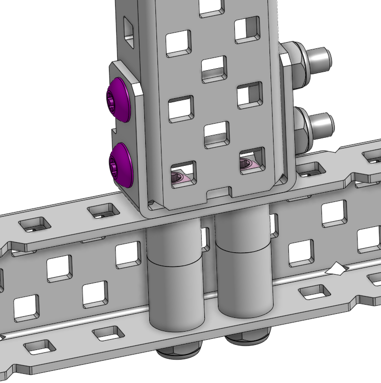

It depends, sometimes I screw the vertical C-Channel directly onto the cross brace (With boxing ofc) and sometimes use methods like an angle channel thats screwed directly onto the cross brace. I can provide images if needed.
I usually just use a L channel bracket like this
will an L channel like that be enough to support heavy movement?
If you could provide images, that would be great.

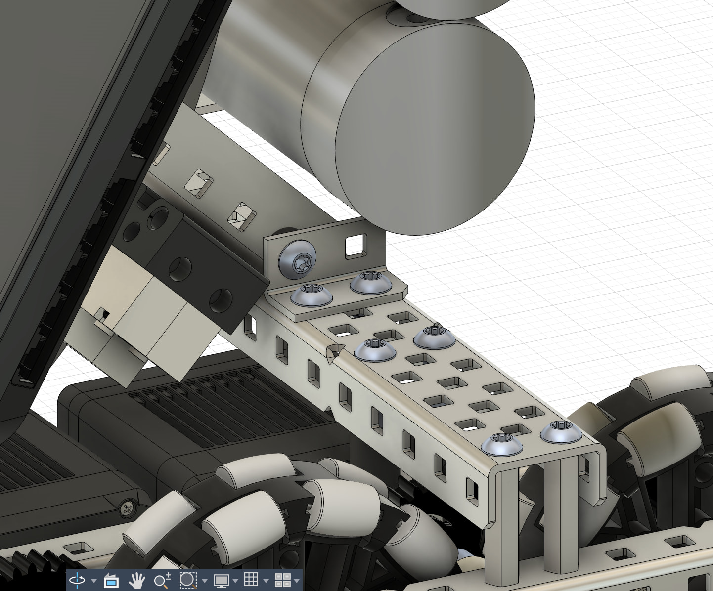

Our teams often use 1-pitch U-channels to go straight up like this- still needs horizontal bracing but it’s rock solid for “front to back” movement along the drivebase.
what type of horizontal bracing did you add?
this one not so much, but if you use a 2 wide L channel it has work rlly well for me
