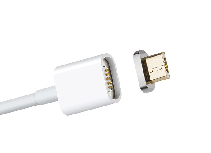

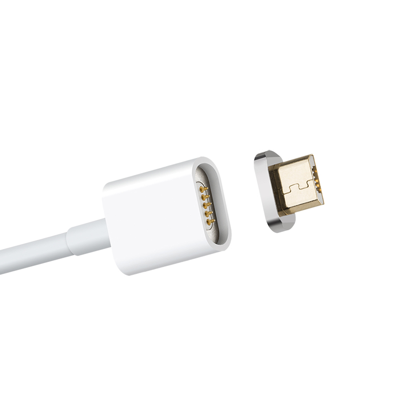

For everybody else, I would highly recommend to use Magnetic MicroUSB adapters - they have the best chance to survive the use case for programming VRC robots. Frequent insertions by young students in the hard to reach places and angles and the possibility of robot driving away while connected is not going to work well for long.
We have one on our robot - it works great and saved both the robot and the computer (from falling off the table) at least a couple of times when students tried to drive without disconnecting cable first.

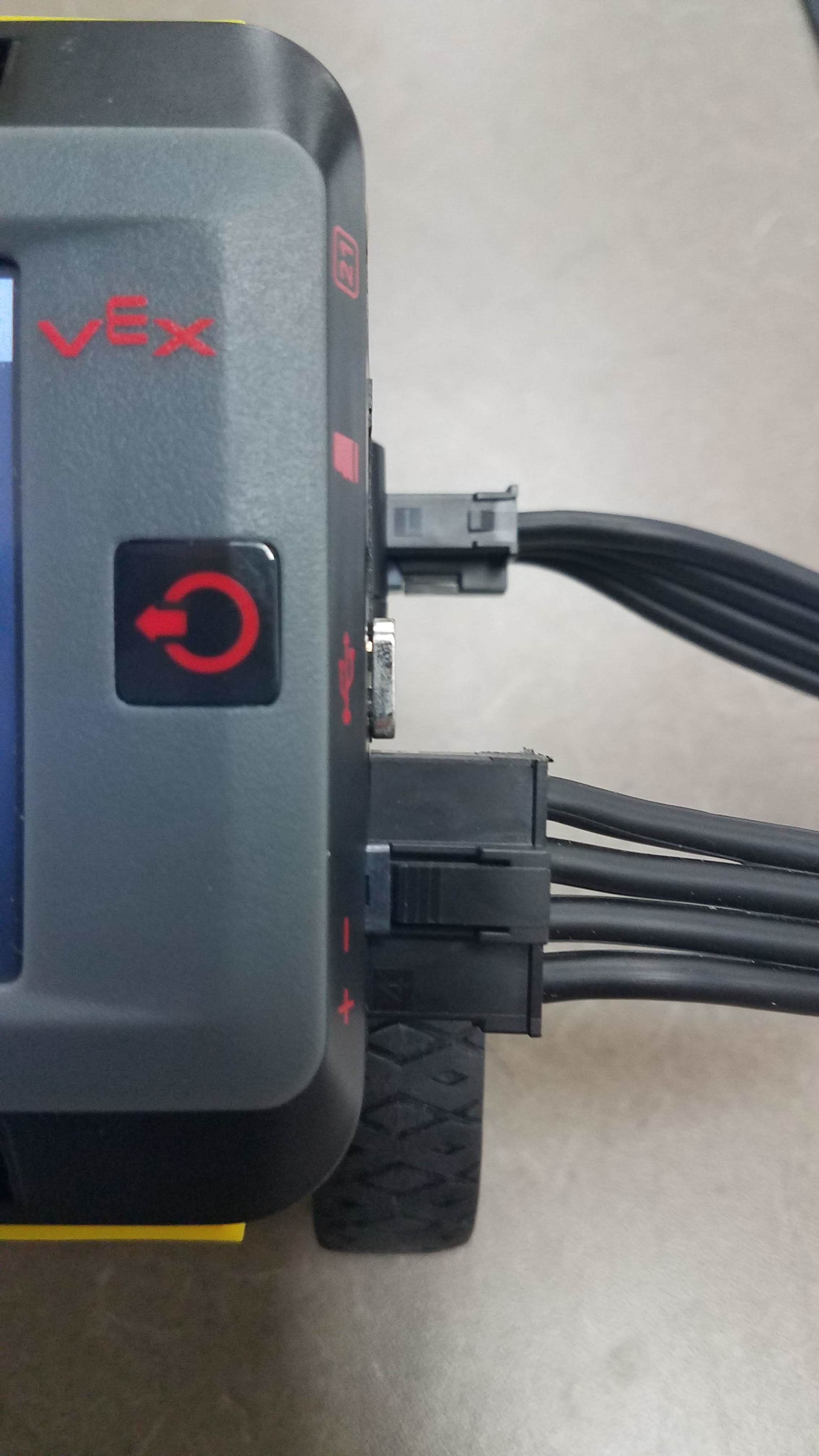

Thanks for this suggestion, I thought this was a great idea and purchased some for the V5 units I use in my classroom. It works really nice. Unfortunately the ones I purchased (https://www.amazon.com/gp/product/B07DHFR62G) where slightly too wide to connect reliably every time - they would run into the latch catches on the side of the power connector. I don’t know if you ran into this @technik3k. I got around it by sanding off those portions of the housing (which have no bearing on the function of the cable, as there is no place those parts interact with on the brain or battery).
Not sure if I’ll make the same modification on competition bots as it may be considered an illegal modification.
Also I found that some of the magnetic USB cables you can buy do not support data transfer, only charging, so read carefully. The ones I purchased will connect in either direction, but only one direction provides data transfer. It is easy to do right - there is an LED that lights up on the top, but it is something to be aware of.
@nnolte, yes that’s a good observation, I forgot to mention that. In the last year I’ve bought about 25 of the slightly cheaper model from several different sellers (usually in the batches of 5). That model fits V5 spacing perfectly and does data transfer, if connected the right side up. I’ve used them for all micro usb devices in my household and gave some out to a few local VRC teams.
So far only 3 of 25 had stopped working due to the worn out cable (where it enters plastic plug). However, I am still very happy, because if there is a high chance of it being constantly yanked by students or chewed by the gears, I would rather use (and throw away) $2 extension, than risking damage to $250 V5 brain or $500 computer that could be accidentally pulled off the table.
