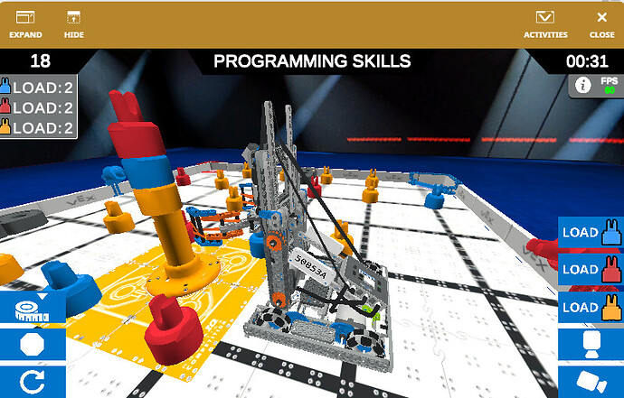

vr.vex.com doesn’t seem to score a stack on the standoff goal correctly. The stack appears to be properly seated on the standoff goal, and according to example this should be 38 points, but it only scores 18. Is there something I am missing here?
I mean, it should be 38 points… It looks like Vex VR didn’t count the standoff goal bonus (10) or the “Stacks scored OR containing a beam” (10) and only counted the 3-colored stack (15) and connected pins (3). I haven’t really messed around with Vex VR, but I’m assuming maybe it was slightly misaligned to be counted? But in the real comp, it is 38 points so…
