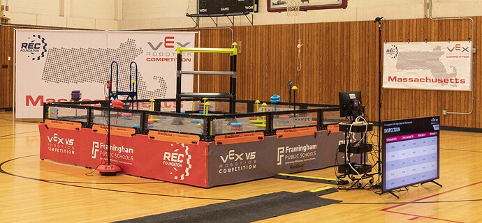

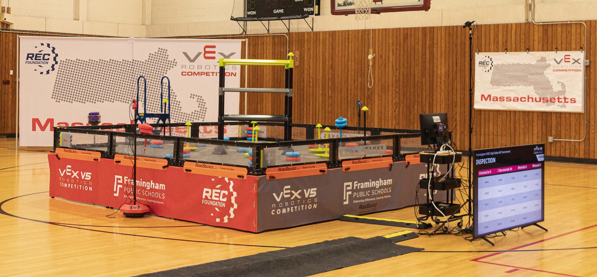

Here is a picture of one field setup:
Thank you! Great ideas and I appreciate the feedback.
lol is that a tipping point base that you used for… what is that a camera?
Drive station cable holders - has a pass through RJ11 in a 3D printed mount.
