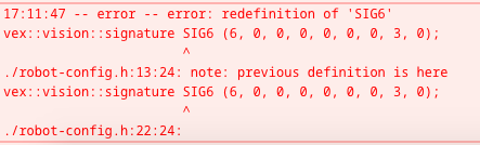

I’m trying to connect two vision sensors now, but I keep facing a compile error from the Sig’s has anyone else actually tried it. Do the signatures between two vision sensors clash?
I removed one camera and there isn’t any other problem with the code.
Edit: Having left school I’ve just thought of the possible solution. Every signature name needs to be different on both cameras, I was only getting clashes on the sigs of the same name. I will try this next week and report back.
Yes, that’s correct. You want different signature names on each one, and the default names are the same. Change the names and you should be good.

Hi, I’m new to this vision sensor and I 'm trying to write my code in Vex Coding Studio. Also, I’m trying to work with 2 vision sensor at the same time but facing some difficulties. For example, 58%20PM|443x134 and I’m not sure how can I prevent the 2 sensors from clashing, can someone help :slight_smile: ??
58%20PM the error is this
Not this? From three posts above.
I’ve tried to change the names but it still gives that same error
Not sure exactly what you have tried, but you need to have unique signatures for each vision sensor (unless you have manually setup the vision instances yourself, then you could share signatures).

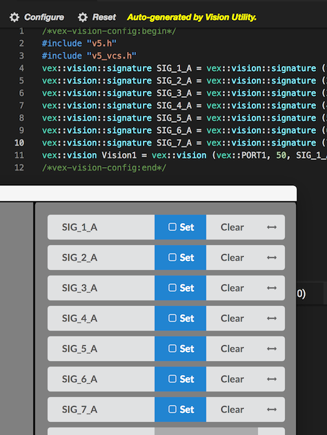

example (using VEXcode)
here is first sensor, I’ve appended “_A” to each signature name.
Here’s second sensor, it has “_B” appended,
