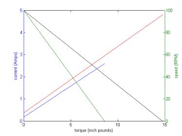

Here are the torque-speed and torque-current plots according to the information on the motors’ product pages:
https://vexforum.com/attachment.php?attachmentid=7470&stc=1&d=1368082974
The red and black lines are for 393s, the blue and green lines are for 269s.
So what I should have said was: for a given torque load, a 269 motor will draw a bit less current but (except at low torques) a 393 motor will rotate significantly faster.
At low torques (less than about one inch-pound) it looks from the graph like 269s are better.
At higher torques than that, it looks like if you need to reduce the current through a 393 you should be able to gear it down to reduce the current draw and still get better rotational speed than a 269.
