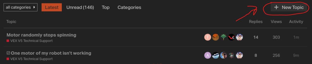

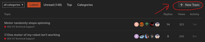

I am having a problem and i need help. My robot would slow down and stop randomly I have changed the battery and it still continued, and the connection is still good
Is this issue separate from the op’s?
If it is i would recommend making a new thread, people on this forum tend to dislike when others bring back old threads lol
(personally idrc and will try and help anyways, if you send pics that would help us see your issue)
idk how to do that :disappointed_relieved:
@kakarot
