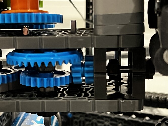

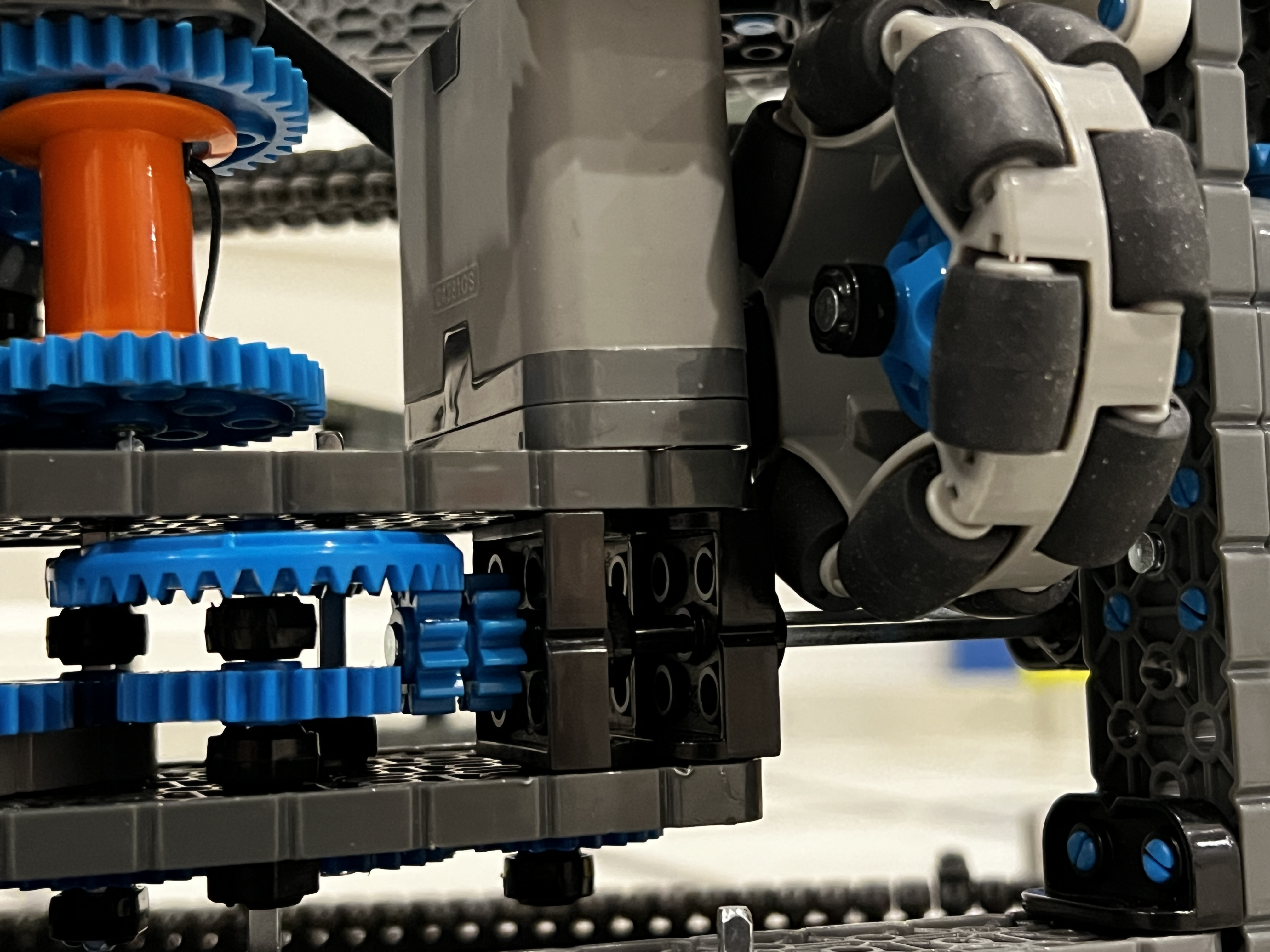

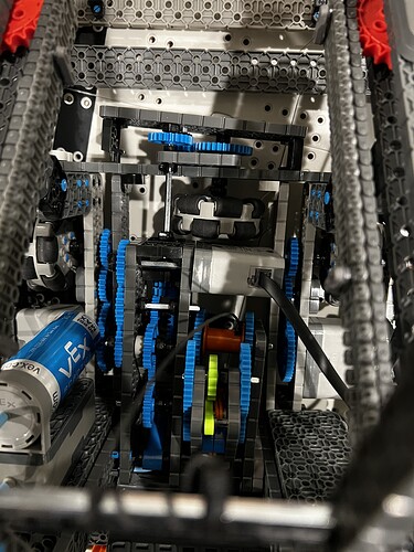

Our team is using motor sharing with pneumatics (sliding PTO). This allows us to power the catapult and H-Drive using 1 motor (we’re at the max 6). The movement of the pneumatics and gears works fine, the input motor power correctly transfers to one of 2 drive shafts.
The problem is the one of the shafts has a 90 degree turn and there we get the bevel gears slipping (we’re using bevel gears). We kept the catapult straight, and have the 90 degree turn assigned to the H-Drive so the catapult is not low on torque. There’s a clicking noise at the bevel gears and they slip, the H-Drive doesn’t move. If the robot is lifted in the air so there’s no friction then the H-Drive wheels turn.
I have tried regular gears at the 90 degree angle, crown gear + regular gear, and finally bevel gears - all are clicking at the turn. What can we do?

Stiffness and alignment are key.
Pictures of the problem are would help.
