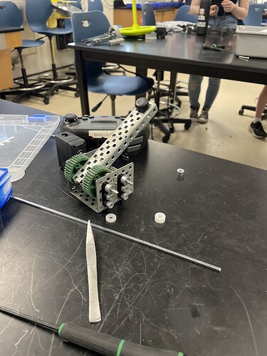

Motorized mobile goal clamp
I was working on a motorized mobile goal clamp and I came up with this design
It works but it loses grip after 30 seconds of rough play any ideas on how to improve it?
My school does not provide pneumatics
Put your motor braking to hold
I did that but it still gets lose

I would research “mechanical clamping devices”. There are numerous methods that use a simple movement to create a lot clamping force.
Also note that motor torque and speed have an inverse relationship. The shorter the bar (lever) and the more you gear down the speed, the more torque you will have to hold onto an item.
I don’t think motors are the way to go for clamping, but since you can’t use pneumatics, I would recommend increasing the torque to 100%.

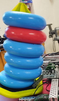

As someone from a school that does not provide pneumatics, our team was able to motorize a fairly strong clamp with a green motor, two high strength metal gears, and two 36t high strength gears screwed into a c-channel. It was able to hold on a fully scored Mobile Goal fairly well for a motor. It can easily hold a empty mobile goal/barely scored on.
Can you post pictures please? Also how often does the motor overheat?
Looking at the design All you should have to do is make the arm half as long and you will have plenty of toque. My team just Got pneumatics this year and I myself had to build one of these with out them.
Haven’t tested out the clamp enough to know for sure how often the motor overheats, but it will definitely last at least one match without overheating.
If it can last a match that’s great. I would highly recommend adding some sort of bar with standoffs to line it up and make clamping more consistent.
yes we did that. after running some matches at a tournament, we found that it wasn’t consistent when other robots are constantly hitting it

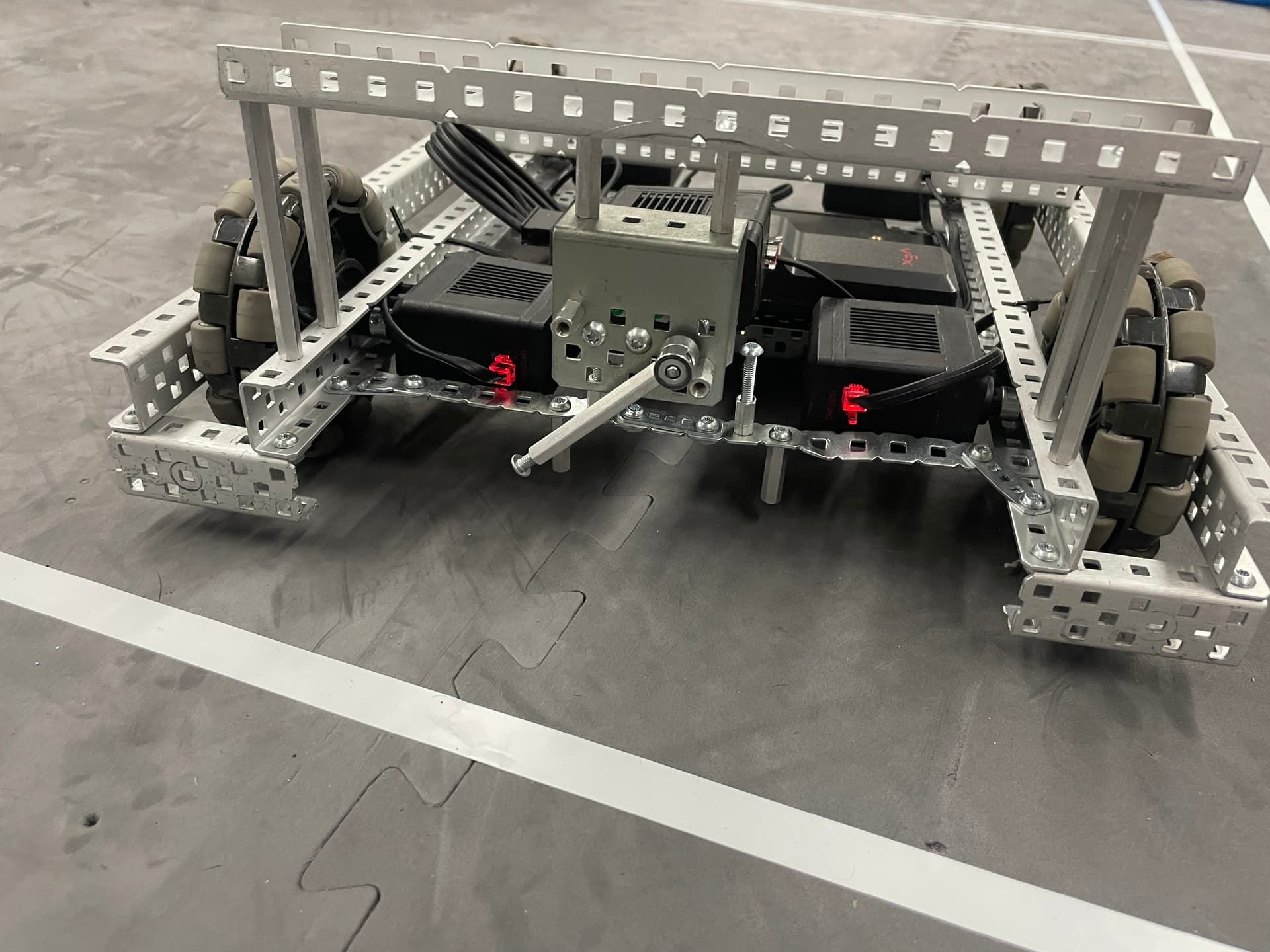

I’m pretty late on this so this might not help at all but my team has one that rotates to the side. like this
this was what our prototype looked like.
To comment about the idea of just having it set to hold for programming didn’t work for us, our programmer just ended up having the motor keep spinning to clamp but with lower force. I can’t find an updated version of our clamp but I might be able to get one on monday when I have the chance.
Trying to spin the motor when it physically can’t will overheat the motor. Setting the stopping to hold should have worked for you, especially since it doesn’t look like the mogo would be applying much force on the clamp due to its horizontal rotation.
Maybe make sure the stopping code was actually running but I would not recommend having it continuously trying to spin.
