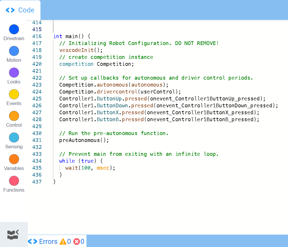

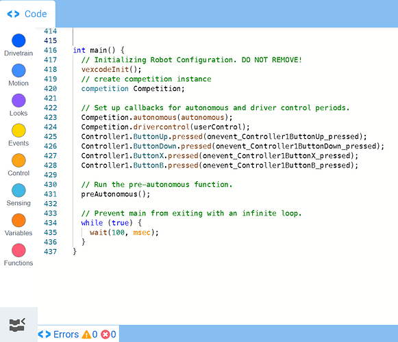

Hi, I am verry confused with my problem.
The motors on my robot only work/spin during autonomous and not during driver or normal running.
I have tried alot of different things like changing brain, wires, radio, controller, motor, clearing all programing, updates etc. and it still doesn’t work.

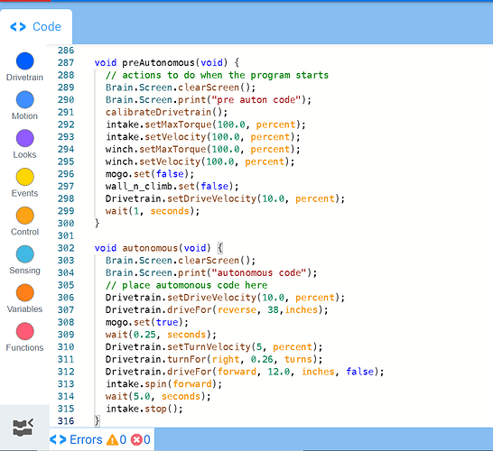

Can you please post both the Auton and driver code.

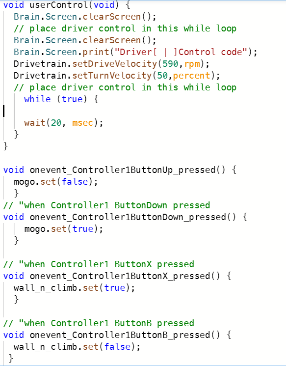

Do you have a drive code? it seems it’s only autonomous code set in unless I am blind and don’t see it.

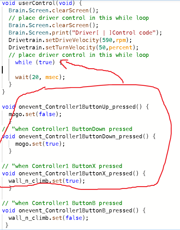

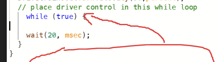

You dont have any driver code, in your while true loop add movements for motors based on the joystick position
I may be wrong because i am not a coder but it looks like you need to move your drive code into this while loop
here is the drive code

that is to set motors/solenoids/sensors so they are ready after auton
you have a comment saying “place drive control in this while loop”, i would suggest listening to it.
This is the vex example code
while (true) {
    LeftMotor.setVelocity((Controller1.Axis3.position() + Controller1.Axis1.position()), percent);
    RightMotor.setVelocity((Controller1.Axis3.position() - Controller1.Axis1.position()), percent);
    LeftMotor.spin(forward);
    RightMotor.spin(forward);
  wait(5, msec);
