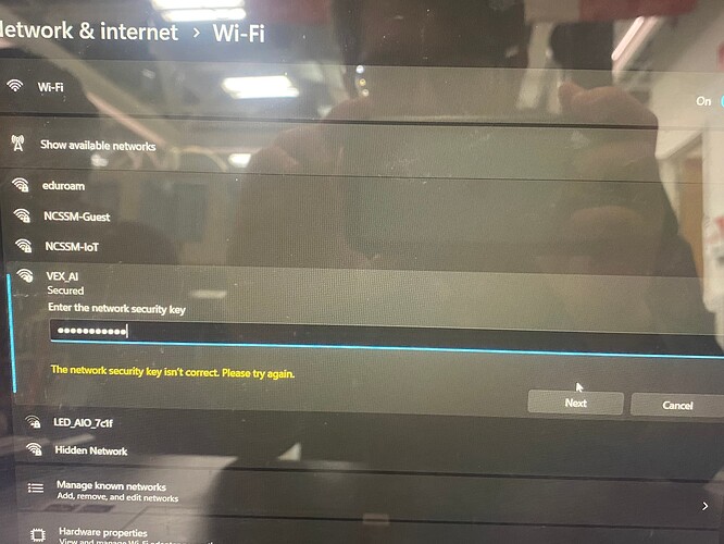

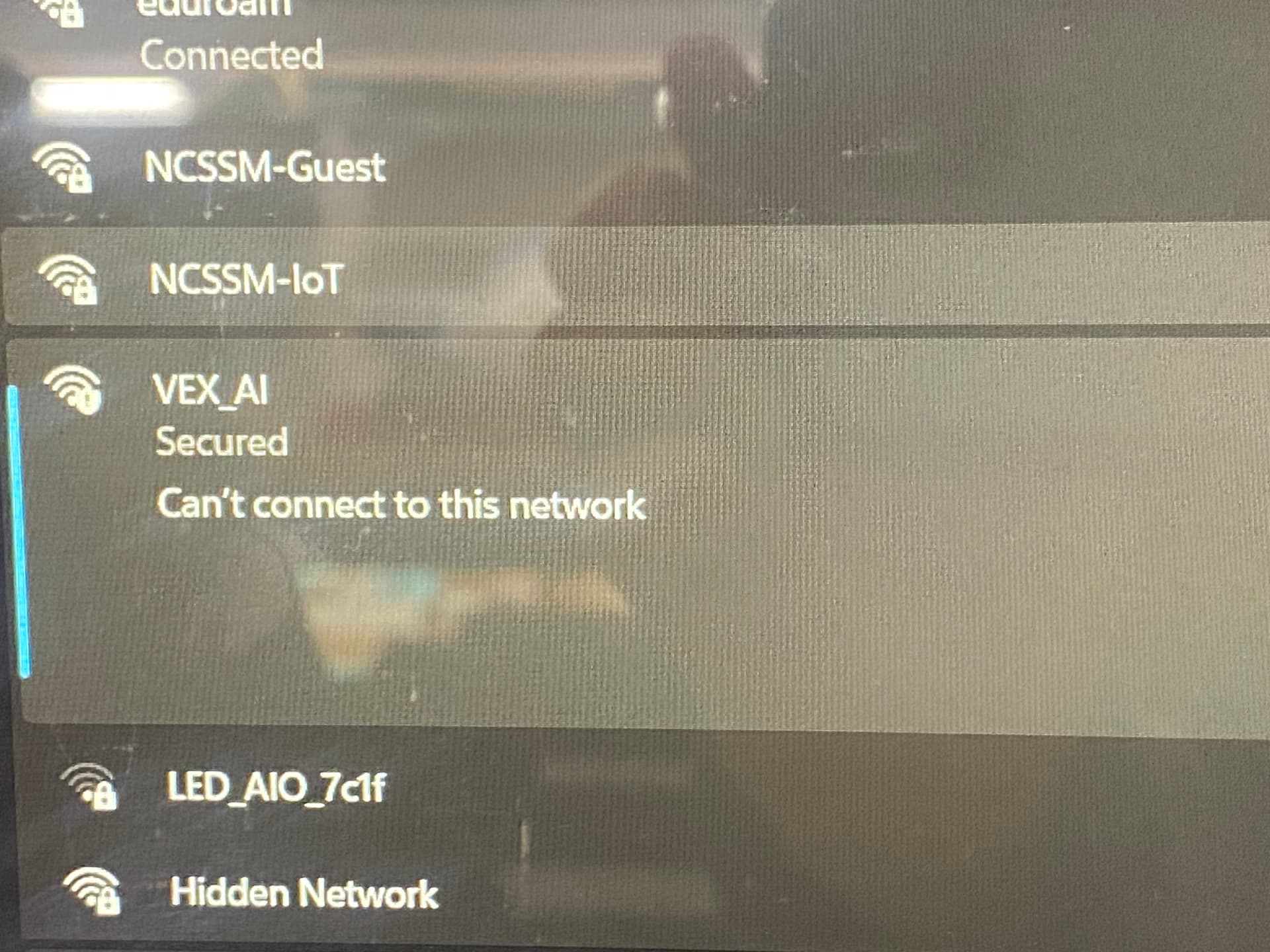

@Mikeyoof25 @jpearman Our team can see the wifi and have changed it to hotspot. The Jetson can “connect” to itself on this wifi. But when we try to connect to it from a laptop it fails. Any suggestions?

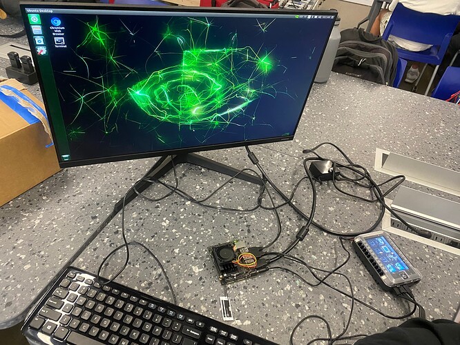

I assume you aren’t trying to connect bia computer when you are also plugged the jetson into a monitor? (Have you asked/checked if it auto connects to its own wifi?). Send pics if necessary about your process.
-Michael :slight_smile:
As seen above we just have the jetson connected to the brain at the moment. We are using the SD card that we received as well. Our goal was just to do the initial wifi connection and access the dashboard before moving on to test the example code on the github.
Thank you for your help.
Hi again @mhilton!

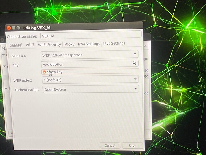

I strongly suggest creating your own hotspot rather than what comes on the image. I also suggest that you don’t have a password for this network, which should bypass your security key error. You can do this by following the picture instructions at this link

  • When editing WiFi settings go under the general tab and check the box for auto connecting to the hotspot
  • make sure that when you create your new network, you choose NONE in the dropdown for security. This should make connecting easier and more reliable

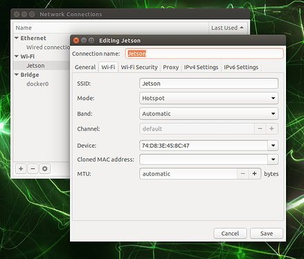

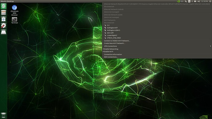

The current Jetson image for the 24/25 season needs a small change to get the access point to show.
From default image.
Use “Edit connections…” from this menu

Select “Jetson”, click the settings button to edit this connection.
Change Device to wlan0 and save.
The Jetson should now enable this hotspot and you should be able to connect to the “Jetson” SSID.
Thanks @jpearman and @Mikeyoof25 we got our connection!
