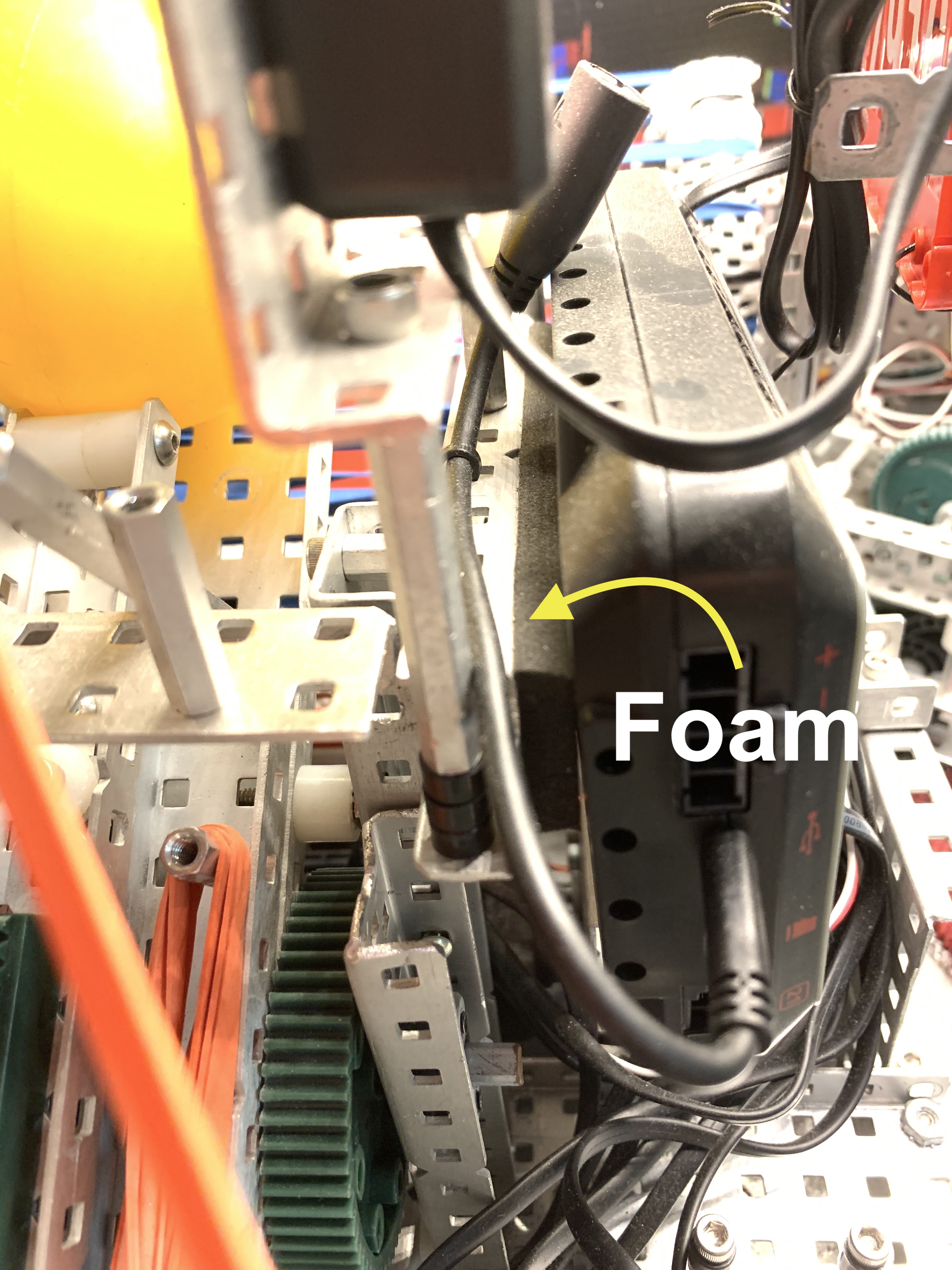

To those who think whitescreens are due to low battery, I think they are more due to static discharge. My whitescreen took place during a match where I had almost 100 percent battery capacity. The moment I whitescreened was when I was mildly bumped by one of the robots on the opposing alliance, sandwiching me between the field perimeter and their robot, likely causing a static discharge affecting my V5 brain. Perhaps I should invest into more rubber links to mount my V5 brain on or dryer sheets to wipe down my robot with before matches?
or not ESD but micro power disconnect. This is consistent with situations we saw early last season and went away when we backed the brain with foam as a shock absorber.
How would you do that? I personally mount my brain using the metal screw inserts in the back, would switching to the plastic mounting hardware with foam be better?

Use longer screws and screw through foam…
If not BO3 (those were the days!) at least they could implement re-match rule for teams who had product failures.
How exactly would that help? Couldn’t the static still go through the long screws and straight into the V5?
