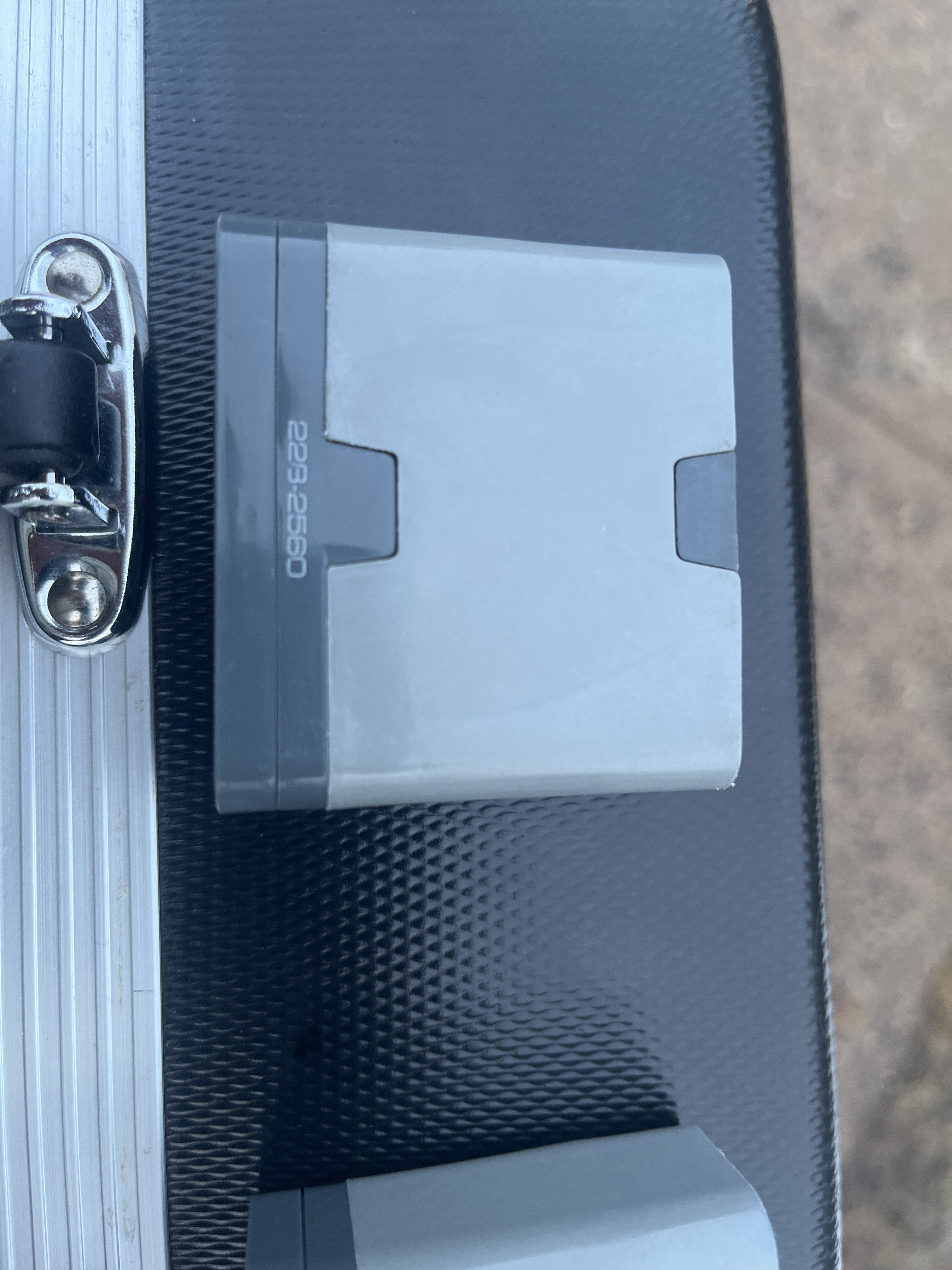

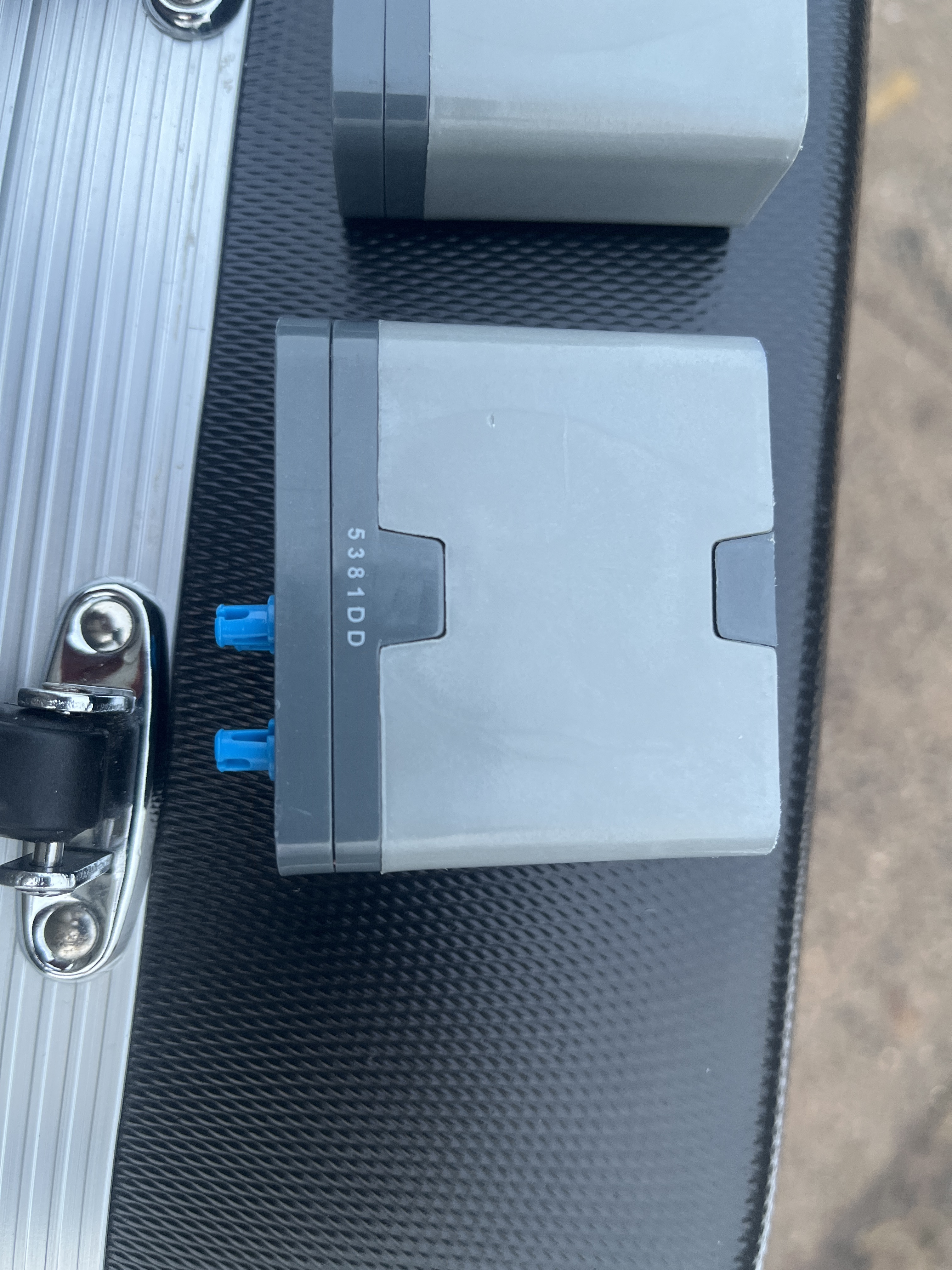

These are images of both motors both are different models and both are clearly scorched on the top.
Also the only motor that smokes up is the right side motor for the elevator not the left motor and the left motor is the same motor model as the image second image after this
